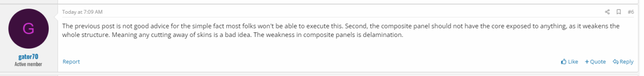

The previous post is not good advice for the simple fact most folks won't be able to execute this. Second, the composite panel should not have the core exposed to anything, as it weakens the whole structure. Meaning any cutting away of skins is a bad idea. The weakness in composite panels is delamination.

As I said, the attachment points described that altered the composite core by removing the skin would never survive theses conditions.

The attachment points described that altered the composite core by removing the skin would never survive theses conditions.
You are the only one talking about removing any skin.
If you are too ignorant to realize how such a simple bolt-thru assembly can be fastened without removing skin, I cannot help you.
