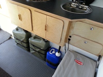

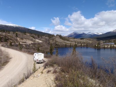

Our CPT (now I guess called "Lake Country"..) camper has been just great so far. We have clocked well over 35K kms on it, including 13K kms this summer in northern BC, the Yukon and the NWT. The camper has performed pretty much flawlessly, pretty good considering it was basically a prototype of the newer versions (ours was the first one...) We haven't beaten on it too badly as far as really hard 4wheeling or bush crashing goes but it has had a good workout for those miles which included the south and north Canol roads, The Telegraph Creek road, part of the Dempster, the Nahanni Range road, Keno road and the Liard trail into the Territories, plus a slew of prairie and local FSR trips. Lots of washboard, dust and rocky roads. The super simple, "modest systems" plan (minimal holes in the walls and the roof (no hatches or roof vents), no hot water, no DC electrical connection to the truck, solar charging only, single fuel with inside LPG tank (airtight cabinet with sump) no built in water tanks, no pressurized water lines system, just a porti-potti (PP), etc. etc., has really been great.

I just did the "winterizing"... Dumped the two fresh water tanks (the marine immersion pump self drains) and the blue "grey water" tank, drained the PP and moved the 19 lb. Lithium battery to the house basement. Done.
