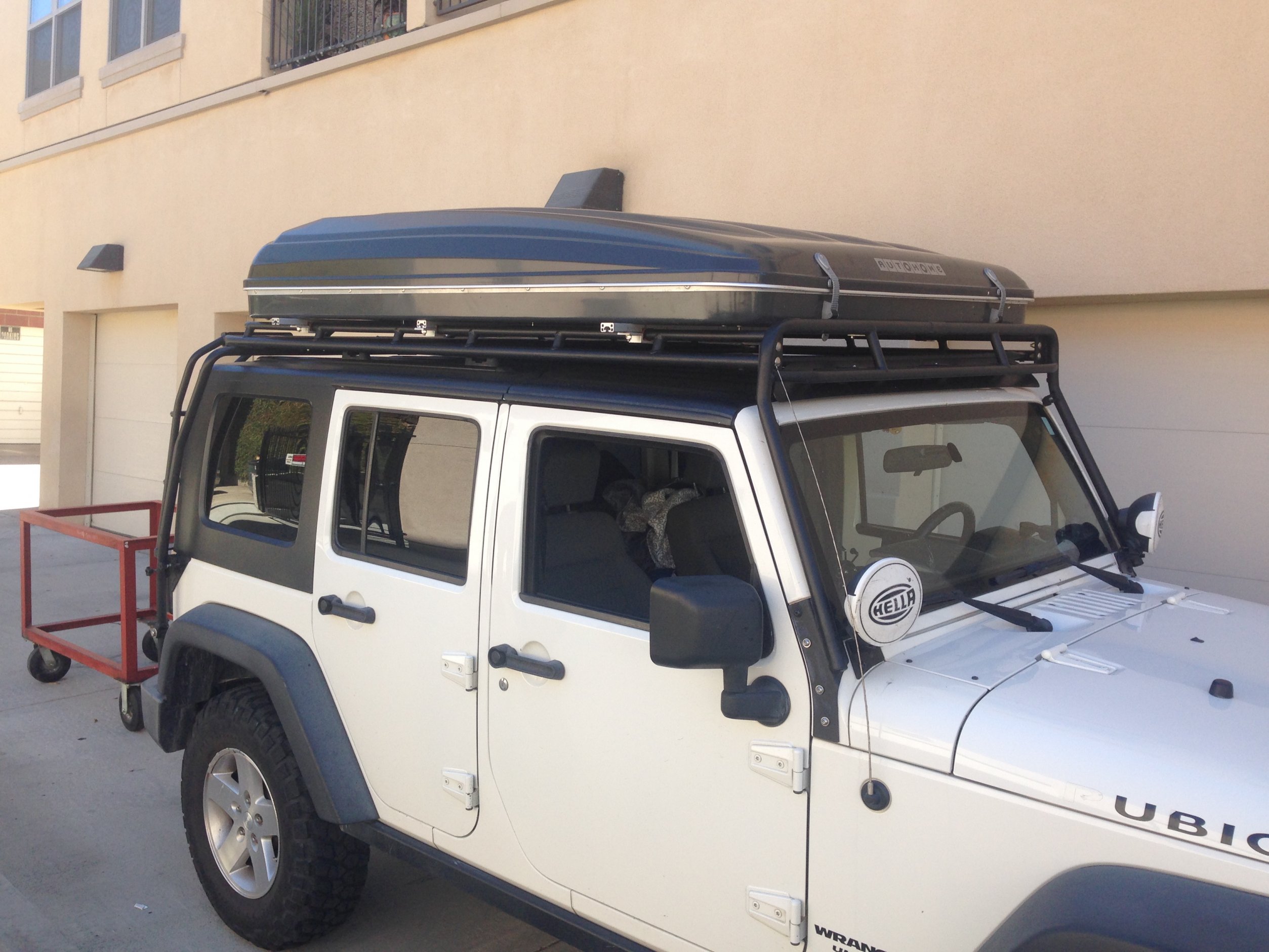

So are there any plans to create this type of roof top camp tent for a soft top. Basically have a hard shell roof liner & pop up tent without the side or rear windows. Just throwing that out there to see if that type of soft top tend would be plausible. I guess a roof rack frame/body rail system could be used in this instance.
Seems like it already exists, the Maggiolina Airtop on an exo roof rack works with a soft top: http://forum.expeditionportal.com/t...rm-and-Gobi-Stealth-for-JKU-Adventure-Package!!
