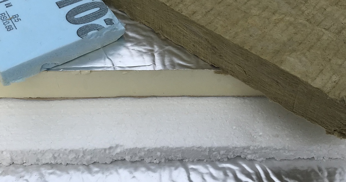

Our PIR is rated at R-7 per inch. Our competitor's PUR is rated at R-5 per inch (per their website). And XPS is rated at 3-4 per inch, on average. PIR is a PUR that is new and approved (PIR is fire resistant, and PUR is not). If you would like to talk to us further, please reach out and contact us. www.rvglobetrekker.com
XPS is R5. EPS is R4. PIR is normally rated at 6. PIR has high R value at warm temperatures, but it falls off at low temperatures. XPS and EPS are the opposite; they get better than rated value at low temperatures.
"In real terms, using polyiso foam insulation panels is probably a poor choice if your winter temperatures dip below 50°F or 10°C. To put that statement into perspective, a wall or roof assembly in Chicago was tested for the whole of December then averaged out. The first assembly using 2" Polyisocyanurate foam panels was compared to the same assembly using 2" of EPS foam and was found to be losing 30% more heat in this study".
Based in this data, peak R value of PIR is about 5.5 at 75F (mean temp) and stays above 5 from 30F to 110F. The XPS they tested had an R value of 6 at low temperature (~30F mean?) and dropped to 5.25 at ~100F.
The R value of PIR is fine for a camper box, but not outstanding compared to other foams.
"Rated at R-7 per inch" .....you could also add a layer of foiled (Reflexcite) faced bubbled (R-1) wrap which I've seen rated at R-30.
Unless you can prove differently (post the LTTR - long-term thermal resistance data) the industry value for PolyIso is R-5.6.
"Fireproof" foam has been around for decades....but it doesn't matter since the FRP and Azdel aren't "fireproof".
