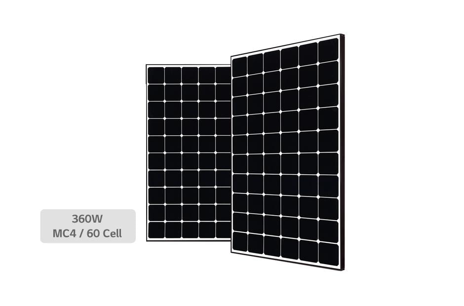

Another reason my LG panel should do well.

As much as I'd like another 360W of capacity in one piece, I don't know that I'd want to wrestle a 40 lb panel off the roof of my camper for remote placement. Otoh, that would simplify things by not needing any attaching hardware; just a pair of channels to slide it in below the fixed panel. I could also use a smaller panel for a remote, but that's no fun.
I've had your mount bookmarked; neat solution. Since I can already tilt the camper roof by opening it, I may not bother with an additional axis of movement.
