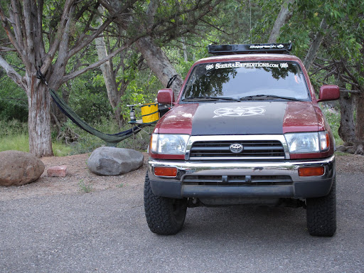

Lookin good, I think the cot idea is great. I was also considering how to build a removable sleeping platform for my box, but I may just remove it all together and run a cot. The ability to set you up higher than the wheel well and the tumbled rear seat would actually make it possible for a 6' person to sleep in the back.
FurthurOnTheFly
Glamping Society
Nice looking truck. Where did you get your hood blackout?
Safety note- be sure to cut the passenger side airbag off when the laptop is on the tray or the tray is in front of a passenger. This has become an issue with the increased use of laptops in our emergency services vehicles (LEO, ambulance, fire) and there are some crazy pics showing up on some of the forums.
Well since this is an older truck I don't really have any kind of switch to do that. I'm not too worried I'd say 9/10 when I'm running a laptop in there I'm solo and usually when I have a passenger I have no laptop being used.
Ya, I'm 5'11" myself so that was what I had to figure out. The Roll-a-Cot is really comfy and my camp set-up/take-down time has been reduced to literally 3 mins or less. Right now I carry two boxes with me: a smaller actionpacker which holds my thermarest, first aid kit, ENO Hammock, garbage can and some other small essentials; and a larger rubbermaid box that is my kitchen. I do have some plans in the near future with a friend of mine to build a new kitchen box which will make the set-up even easier. Hopefully we will get that done by the end of the summer!

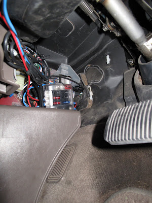

First we were able to cram the Fuse Block by the drivers side kick panel keeping it dust and hopefully water-free.

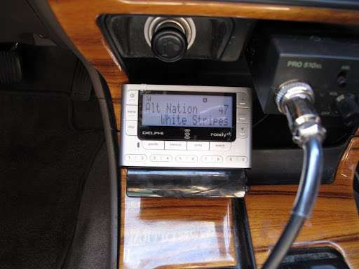

From there we were able to finally get the HAM radio installed, the YAESU FT-8900R. I moved my scanguage to just below its original position on the center console and put the radio face where the scanguage was. The main unit of the radio is mounted under the drivers seat. I love this radio! You can usually find me monitoring those two stations in the pic so don't be afraid to say hello!
You can also see in that pic that we put in an additional 12v plug there below the scanguage to power the portable XM radio. We were unable to hardwire the power for it. This is the XT Roady radio which we also have the boombox for so we can finally have decent camping music wherever we go! Does this make me a glamper now? :Wow1:

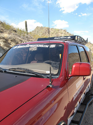

The ham operates off the Comet SBB-5NMO Dual Band Mobile Antenna on a Larsen Mount.

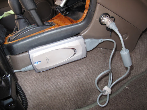

We also added an additional 12v plug to the passenger side of the center console. This was for my IGo system which powers my laptop and cell phone. I highly recommend this system for anyone who does a lot of traveling around! With the powerpack I can power my laptop and my charge my cell at the same time on only one plug; this is important for me since I tether my cell phone to my laptop for the internet connection. You can purchase additional 'tips' for whatever you want to charge like a MP3 player. The end of the powerpack also changes out to a regular 110v plug that you can use in the coffee shop or hotel.

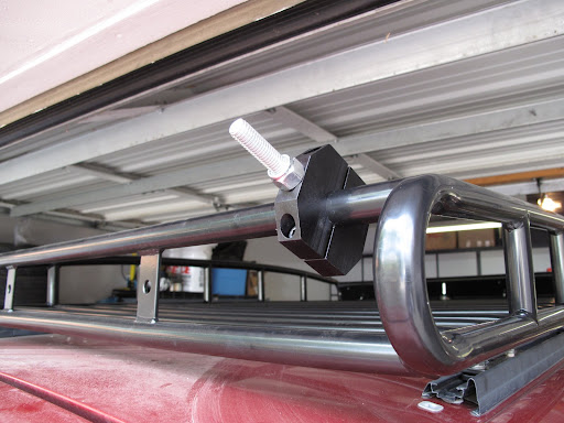

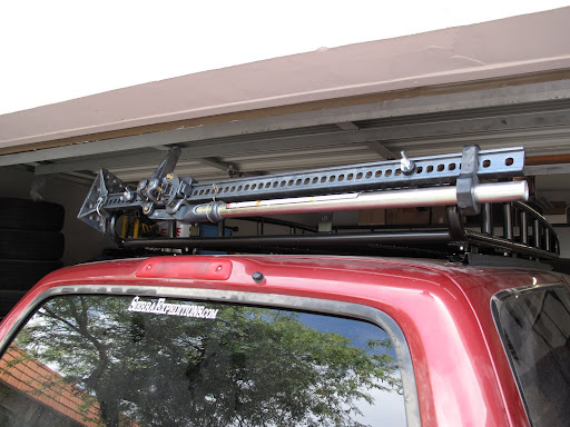

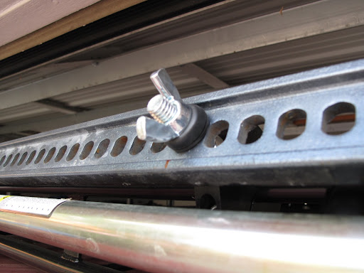

Next was getting the Hi-Lift mounted up on the Baja Rack. It's been sitting in the garage for over a year now since we switched to the big orange marshmallow for the FJ, so I claimed it as mine! I didn't want to pay $50 for other mounts so this is the home-brew version.
$10 engine mounts from ebay and about $14 in hardware from ACE:

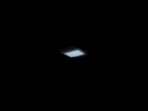

My last project of the weekend was replacing the horrible interior lighting. Lucky for me AZFJ has had a group buy going on for LED replacements for $30. These are not great pics but the difference is truly amazing!
