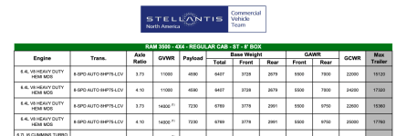

First, some info on the types and capacities:
I have been looking at the D2 (pickup) type, 4x4, Longhorn (highest trim in a regular/single cab), with an 8' box.
Within D2, there are single and dual rear wheels (DRW) variants.
The following snippet from the Ram web site is where I got the 4,600lb payload and 11k lb GVWR:
The two rows with the 14k GVWR are the duallies (that is basically what the (1) footnote says if you go to the link below).
The whole thing can be found here, including the diesel sections of the tables:
https://www.ramtrucks.com/BodyBuilder/service/Image?imageId=MtQrP/FqLY5r/est8MtGjGgHzAHGUTU0WB3rWuqSY7YmQ2vEhuBWBFy6Od5Hdu/D
And for reference, here is the same for the DD (meaning the C/C** (cab/chassis)) versions - two PDFs since the regular and crew cabs are separate tables):
https://www.ramtrucks.com/BodyBuild...jGgHzAHGUTU0WB3rWuqSY7YmQ2vEhuBWBBcRdqxuHzmx
https://www.ramtrucks.com/BodyBuilder/service/Image?imageId=MtQrP/FqLY5r/est8MtGjGgHzAHGUTU0WB3rWuqSY7YmQ2vEhuBWBHtxZ5RVVJiE
So, going to the dually version, you add 2,640 lbs more payload. I think the spreadsheet is in the ballpark, and i am a few hundred lb over the D2 weight limits, and WAY under the dually version. Looking do-able!
