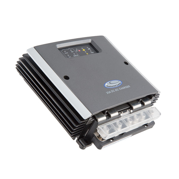

If you want small and to go w/ a ready made DCDC charger, the National Luna is small, but excellent. Been using mine for 4.5 years without a hitch. This is what ATOverland uses in their builds.
