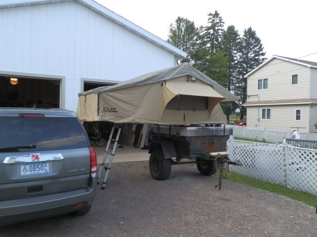

Haven't done much, been to busy building the new shop (garage burned in Jan)
I did manage to get out and use it once in June, and on Tue I mounted my new RTT on it!
Now to figure out how to get it to over 6' when parked, so I can use the annex. Yet keep it at lid height for travel.............

Will do... more coming this weekend. I just saw a pic of my new CVT Mt Hood RTT set up, well its sister. WOW that thing is big! I got it with the annex included (they all come with an annex) so if I decide to mount it on the XJ or even the Caravan (as in Dodge Caravan not European Camping Trailer) I can use it.
