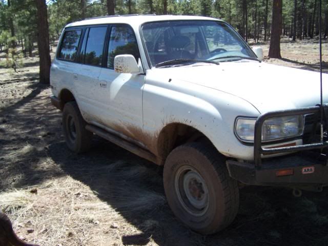

Here is what the steel wheels look like on an 80 without flares...I could measure the back spacing tomorrow.
Pskhaat
2005 Expedition Trophy Champion
Yeah, I'm on a BB (mobile) can't make 'em out, are you running 15" LC40 wheels???
MoGas
Central Scrutinizer
SWEET. Are those 15"? Anyway to get a head-on shot with the wheels straight ahead? What kind of wheels are those?
Those are Aussie 16" Toyota split rims with 7.50-16 tyres. I could get a better shot, but it may take a few days. I'll have to put them back on.
