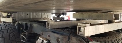

A couple issues with subframes that use fixed pivot points are a) they don't match the natural twist of the chassis perfectly, introducing stresses, and b) these stresses in addition to the ones you get from just carrying the load, are concentrated on a small portion of the chassis. The spring loaded subframes spread out the load better, but have other issues.
These are called "Energy Suspension Universal Body Mounts". I used the soft ones. They go between the subframe and chassis. If you wish to have a pass-through (and I think you can just cut a hole above the rear seats for that) then you will want the front of your habitat to follow the rear of your cab pretty well... which means have the front mounts spaced wide, and the rear ones on the centerline so they can tilt. They do this with very little resistance. You'll need to bridge across your frame rails in the rear with beams.
The frame rails are surely a standard 34" width, so if you position the front ones on the rails that should be plenty of width. It takes a good amount of force to squish these 1/8", so even 1/4" (1/8" up and down) over 34" won't end up being significant at your pass-through opening.
Thought this might explain a little better. It's simple... just need to drill holes and insert bolts. The weight is distributed on each of the 8 bed mount locations. The beams are 6061 Al. All of it weighs ~100 lbs. I made the floor/base strong and stiff so didn't need a regular subframe.
You would need more of the isolators with a heavier camper. The ones up front that are wide apart will need to be pretty close together, but the rest can be distributed along the length on the mid-point between the rails.
