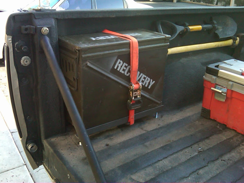

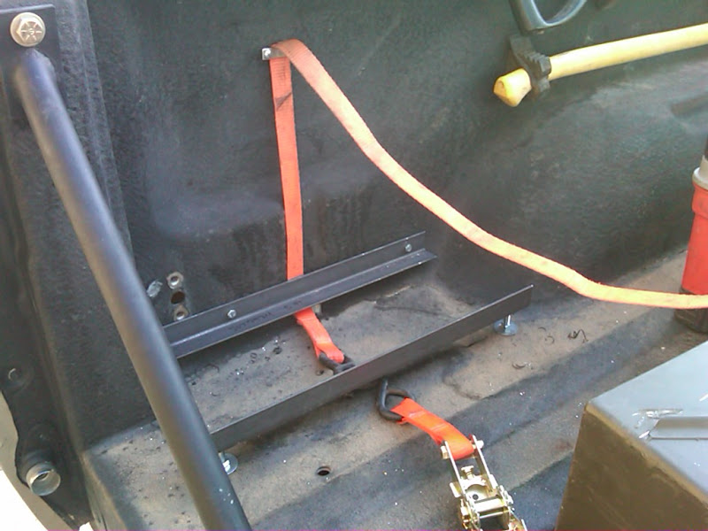

I got to mounting my two 20mm cans today. I would have loved to get them to sit on the floor but with the bed edges being curved, I had to raise them up a bit. All in all, pretty straight forward but the 115* heat didn't really help it go any faster.
