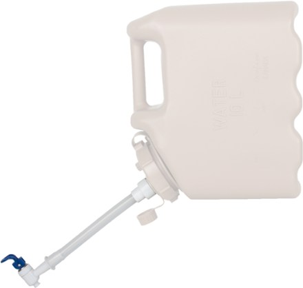

One of the cons to Scepters is the odd size thread on the small cap. One of the big pros is the flexible spout Scepter makes.
The spigot can be clicked on to run or very precisely controlled for water conservation.
The spout wasn’t long enough for me, so I put both ends on a longer hose. It just took a 1/2” SS barbed straight connector on the can end and pressing the spigot‘s barb into the new hose.
I put my Scepter on a riser and made a real vent hole sealed with a SS 1/4-20 bolt. The hole was tapped for the bolt. Scepter’s are plenty stout to tap a thread into. We have found the gravity feed to work far better with less water, weight and complexity vs an electric pump.
I set it up as a simple dispensing station that makes solo hand washing or other use simple — just tap the blue lever with arm or elbow.
The magnetic ball head is sturdy, but easily pulled off for use on the tail gate or inside the camper.
We often cook inside the camper (usually reheating or coffee, etc) but there’s plenty flow to fill a or cup or water bottle inside. We leave the whole system set up and ready to use with no setup with the spigot secured to a small steel plate magnetically mounted above the Scepter on the camper wall.
Its never come loose on even the roughest trails. No drips, no spills, no errors … so far!
