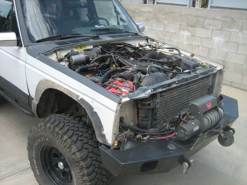

My mechanic asked that I remove my Warn bumper and winch along with some of the underside armor before he starts working on it so depending on how much time I have available, work should begin maybe in two weeks.

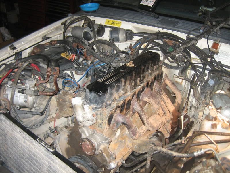

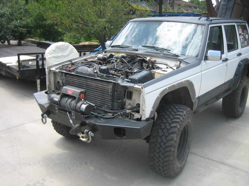

I dropped off my stripped down Cherokee at the shop this morning. Removal of the skip plates and front end makes the rig look so naked.
I'm planning my own version of fender flares so I took off the Bushwackers.

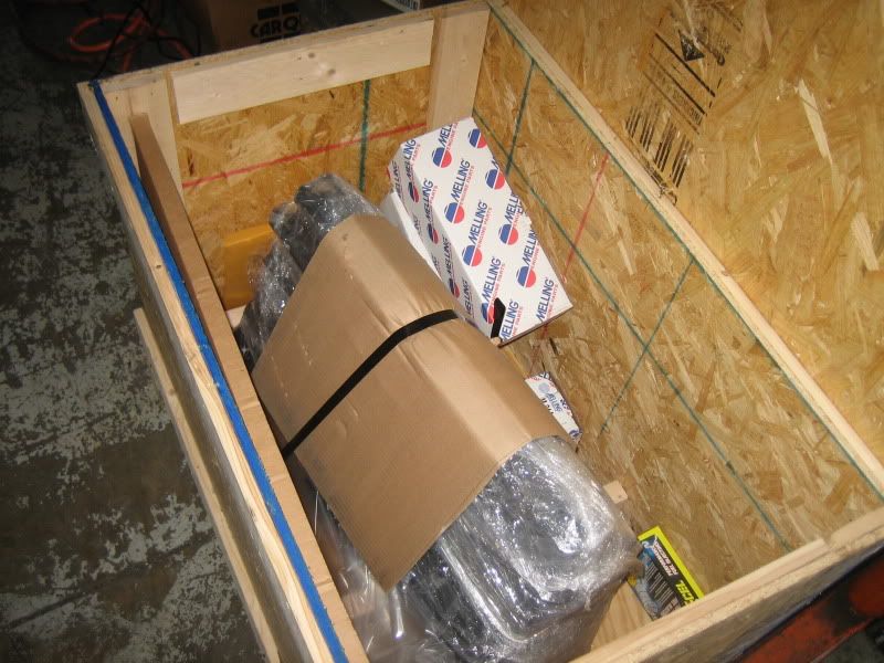

Here is the new engine still all wrapped up:

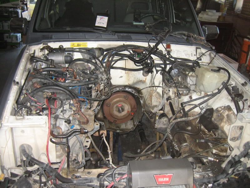

slow progress
The rear bolts that hold the bell housing are a real pill to get off. Once they are loose we should be able to remove the engine.

Root Moose
The one(s) at the top of the bell housing are a real pain. Torx and hard to access - I forget if there was just one or two at the top.
We got tired of fighting with it and ended up pulling the engine with the whole drivetrain last time.

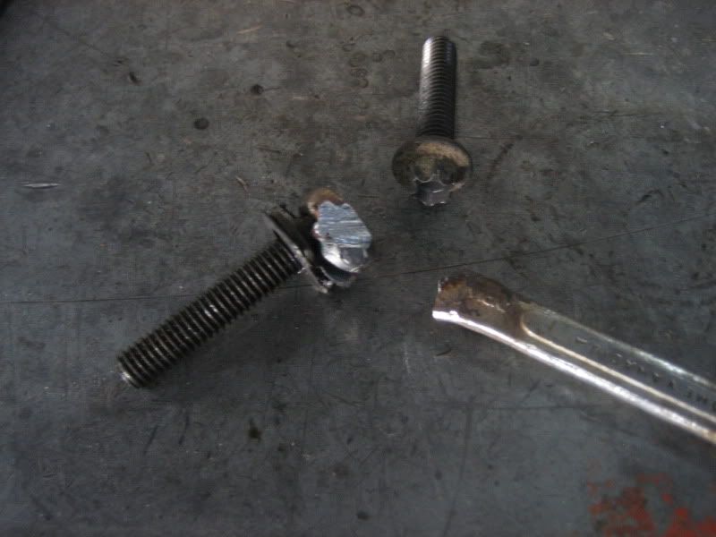

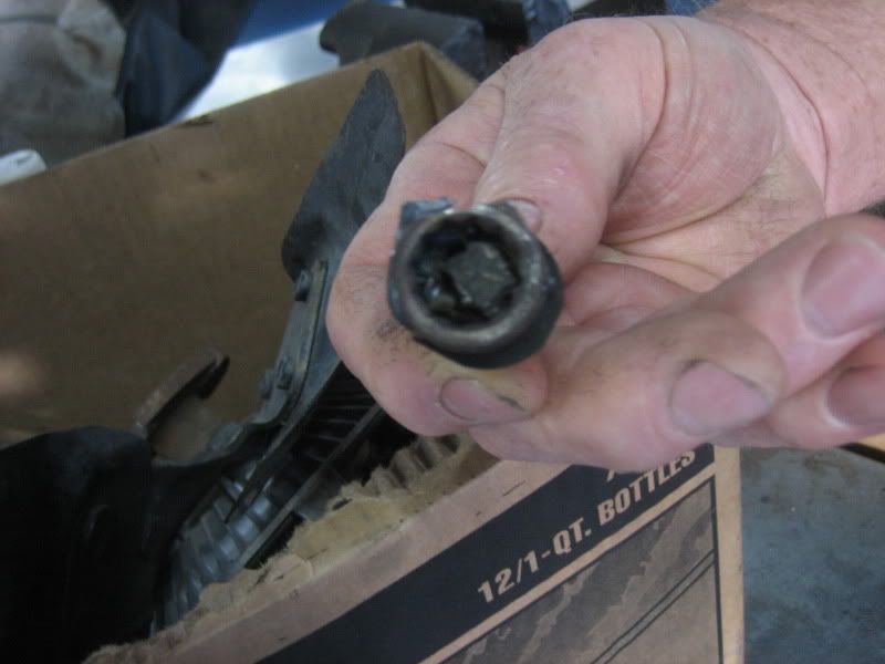

finally got those "stink'in" bolts out!!!
It took the sacrifice of a wrench and the use of a MIG welder but we finally got the last two bolts out and the older 4.0 engine is out!
We ended up welding a wrench to the star bolt to get a good enough grip to break it free.
