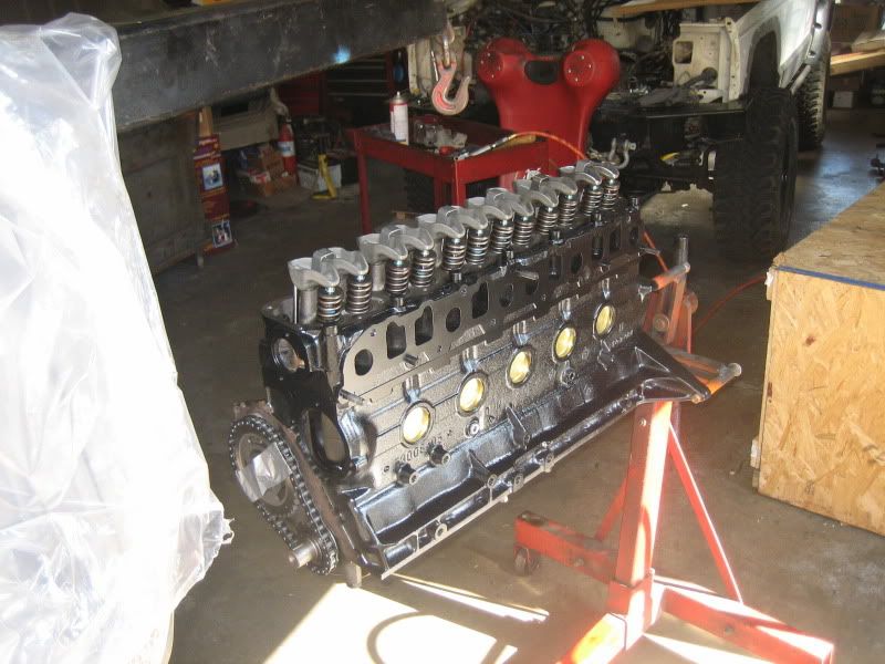

Explorer 1
Explorer 1
Out with the old and in with the new
Now that the old 4.0 is out the process reverses itself and many of the parts taken off the old engine are now re-installed on the new 4.6 Stroker.

Explorer 1
