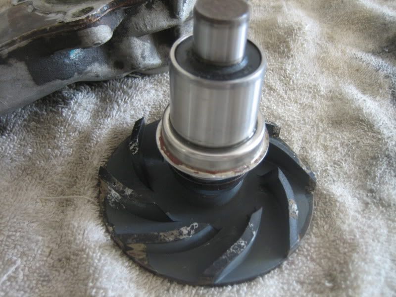

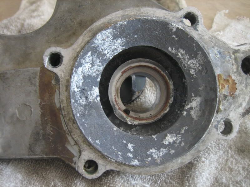

What's with the "white stuff"????
About 5000 miles ago I replaced the OEM water pump and thermostat housing with a Hesco high preformance model. It appears that the serpentine belt was too tight and cause an early failure of the bearing.
I looked into replacing the bearing myself and found when I presses the assembly out of the housing, a white flaky substance has bonded with the aluminum housing and impeller.
Anyone know what caused this, it may have something to do with the brand or type of coolant

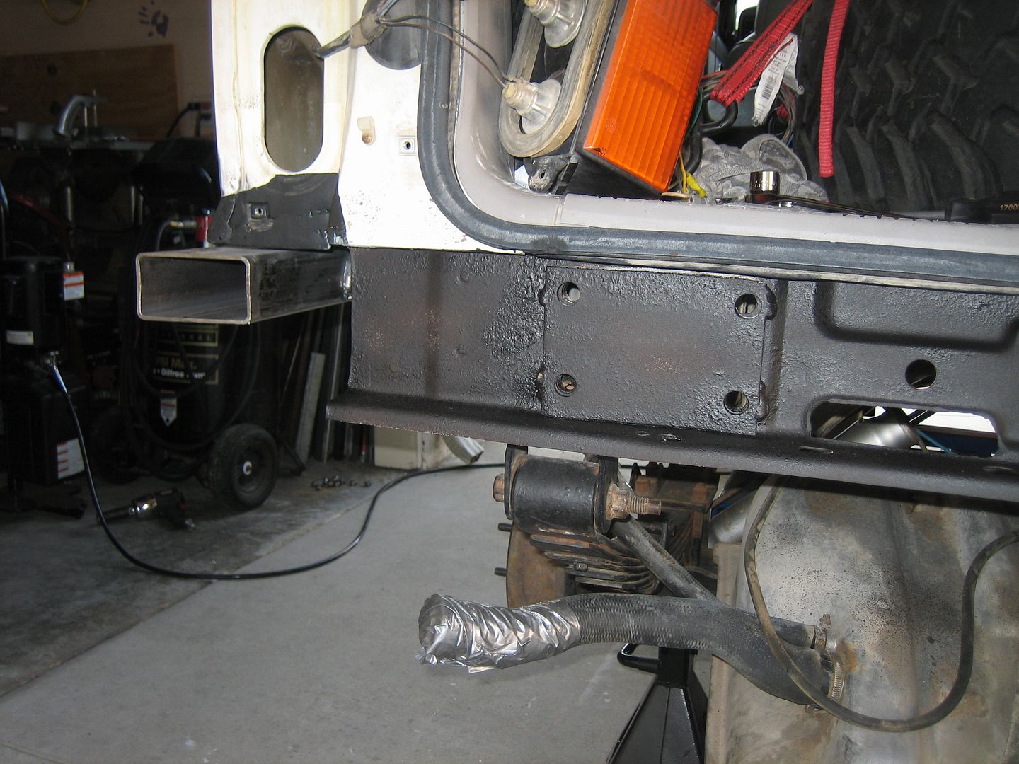

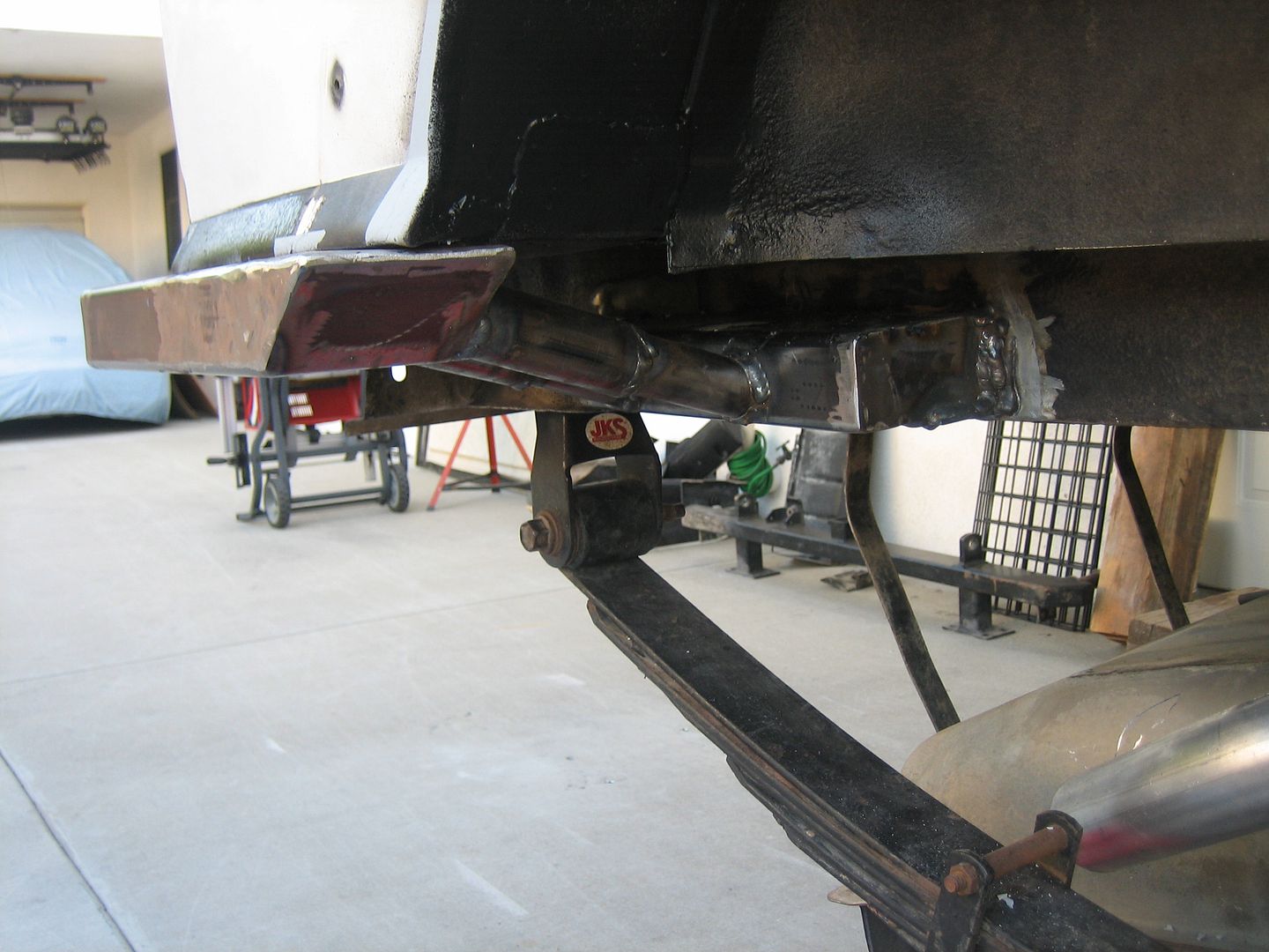

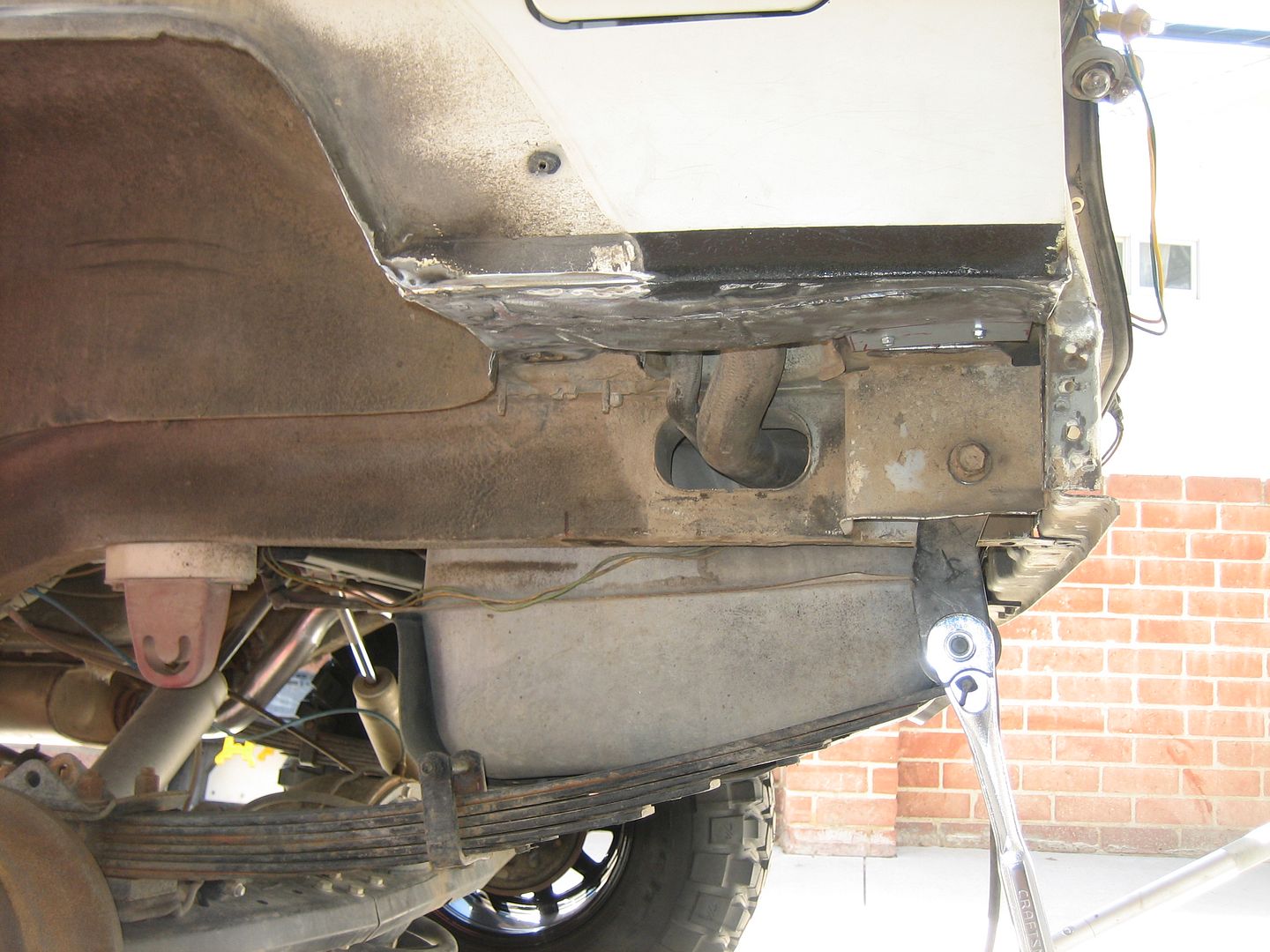

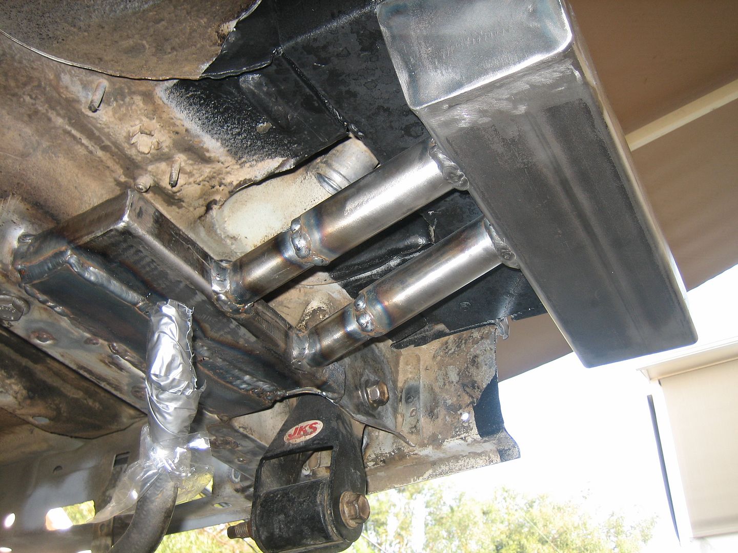

Went ahead and installed the bigger tires (35's) and 16" rims. With the Bushwasker flares removed seems to clear ok without any further cutting or lift.
I continue with the uni-body reinforcement for the roll cage I am designing will proabably start a new thread on it.
Here is a pic of some of the rear uni-body work so far.
