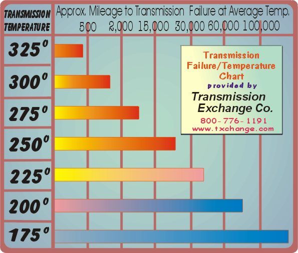

Charts that were helpful....
Jason,
You might find the following charts helpful in deciding when to change your trans fluid and if you need additional cooling.
Also see:
http://www.digi-panel.com/digidevicesweb/trannyoil.htm
I installed an additional cooler ( besides the factor cooler) in a cut out section of my hood, It has a fan which I have currently activited by a switch. Once I hit 210, I turn the fan on and have found that even in the worst climb not to exceed 240 degrees.
