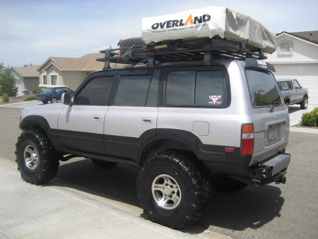

I let it all dry overnight.
I was a little worried since we are having some "Winds of DOOM!" out here in Northern AZ that there might be junk stuck in the liner. It was tacky like tar last night, but only 1 mosquito sized green bug that easily fell off.
The stuff is like rough sandpaper now, so I can just file down the bushes on the trails. :p
I bought the kit for $89 at Autozone. Its a 1 gallon can of Herculiner with 1 paint brush a roller and 2 roller pads. The rollers give it a nice texture and its quite easy...no overspray to worry about and extra masking to try to prevent it.
On IH8MUD, I guess the "proper" way to fill the holes is to weld them shut and grind, sand, fill, prime, sand, etc...
There are like 50 holes per side. I don't see this stuff coming off anytime this century, and all that work to just get rolled over with herculiner - I think it would be a huge waste of time. If you were planning to remove the flares and then have the vehicle PAINTED, I could see the "proper" technique being used.

Looks good.
