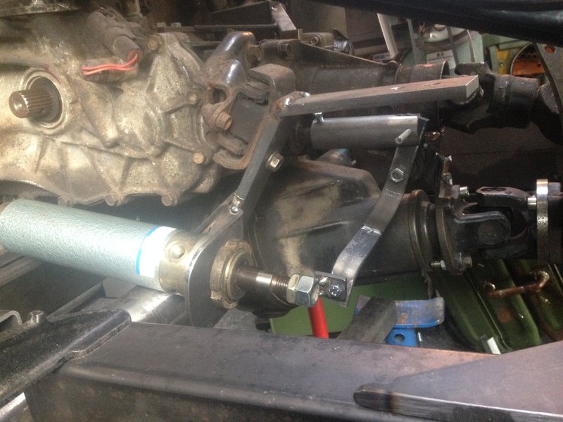

And started with the shifter:
Spent another day working on the shifter linkage. Redid every part at least tree times until i had it working properly.
The forward and backward motion:
And left and right:
This is first:
And reverse:

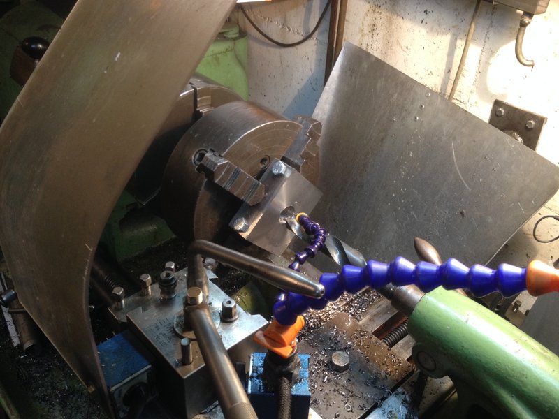

Then i started building the first bushing fot the bogie axles:
Thought this was to wimpy:
So i put some threads in the saw and used my stuff from the mill to make it solid:
Put some threads in the bushing:
And started turning it:
