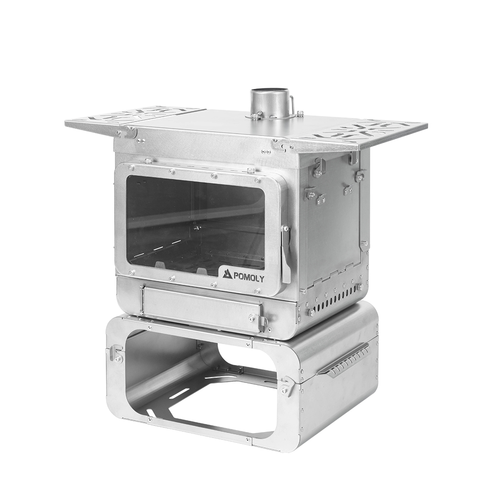

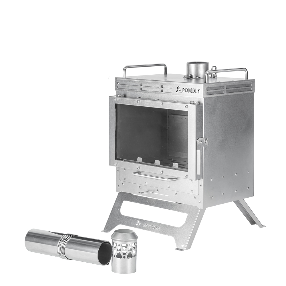

Regarding the stoves I was reading on Polmoly's website that they are often used in RV's and trailers so there is some consideration for that type of usage. Perhaps there is the option of getting an air intake retrofitted.
