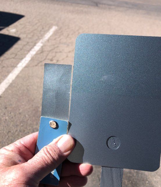

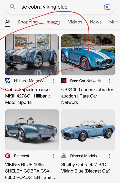

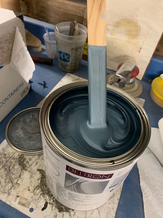

Well, I jumped the gun a tad. The body for the Jeepster is still at the paint shop, but is supposed to be sprayed tomorrow. The interior, firewall and underside have been shot, and they look great. You'll notice that the color is almost identical to the original Jeepster blue metallic, but slightly more blue. It's actually an AC Cobra color that we mixed up using original AC color chips.
Here are some shots.
