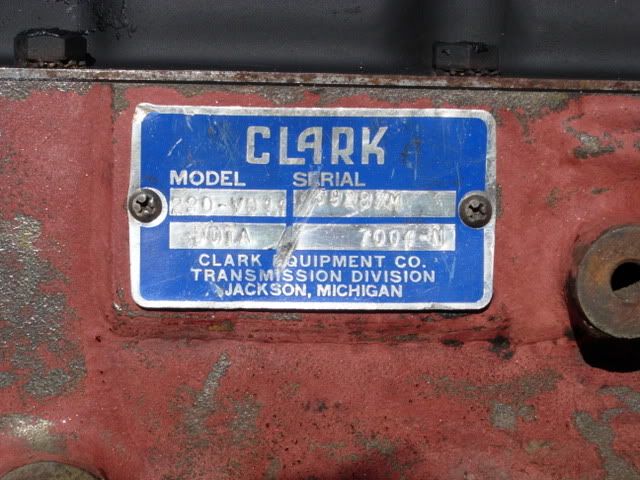

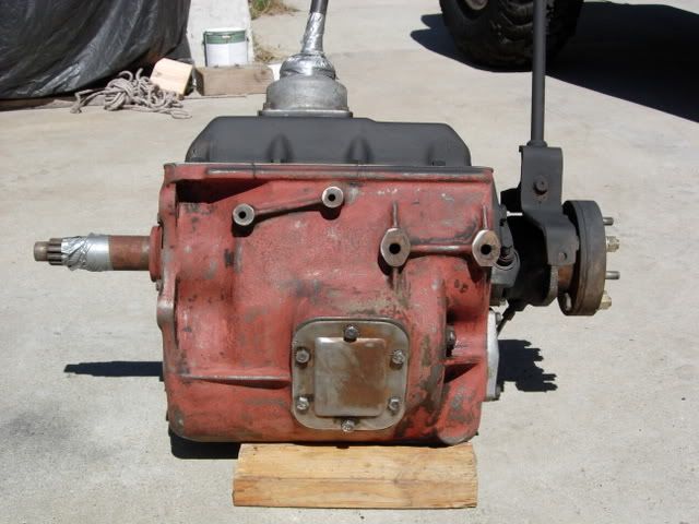

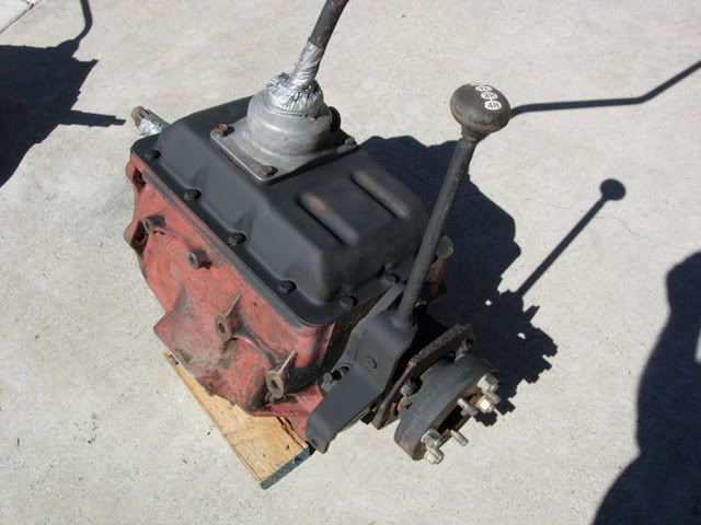

Clark 280VO (now the Eaton Fuller FS4205) 5.98/3.50/1.86/1.00/0.80/5.04R 20% O.D. 208 pounds, dry. I have one of these in my garage ready to go behind a Cummins. It came out of a 4WD 1979 Ford F600 dump with divorced T.case. 1-3/8", 10 spline stick out shaft. You must use a Ford clutch and T.O.
You can see the t.case lever still attached for the divorced NP205.
