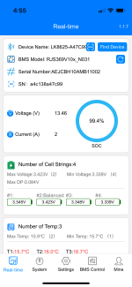

I also turned on the system. This is the readout from the app provided by ACOPower. Bluetooth monitoring is built in to the battery. The 12VDC mains box didn't work, and I think I know why. The solar input worked great. I was getting 2amps from my dirty partially shaded panel late in the day. 2A doesn't seem like much, but the panel maxes at 8 amps.
