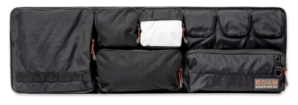

another storage idea you camp-xers might appreciate - i know ox is working with a company to provide soft pouches for various locations on the interior, but this is a perfect fit and holds a ton of stuff
Hi Crystalclear, I saw your photo of the Mudstuff storage bag and it looks like a perfect fit. Did you have any issues ordering this from the UK...were there any unforeseen fees or taxes? Thanks for sharing your storage ideas.
