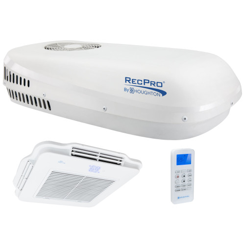

And since i am sure this is going to be the #1 question for the peanut gallery and the "that wont go where i go" types, here is the Air Conditioner i am using:
Houghton Bel-Air HB3400 (rebranded by RecPro, but one that arrived to me came in a Houghton box and is labeled Houghton)
Made in Austrailia
Built in Soft Start
Low Profile, only 9" High
It does have a huge footprint on the roof though, so roof layout needs to be planned accordingly
An often overlooked, but key feature for me was the shallow plenum/controls inside of the camper, it sticks down a little less than 2". I can walk under it with an inch to spare and no crouching
