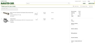

I recently ordered some tools and supplies for this project, and I highly recommend investing in specialized tools. The Ancor Premium Battery Cable Stripper is a great tool, eliminating the struggle of carefully cutting insulation without damaging the wire’s fine strands.
While Ancor Cable Tie Mounts and Thomas & Betts Cable Ties cost more than some alternatives, I’ve never understood why builders pair premium components with cheap wires, lugs, or ties. Budget options are fine if they work for you, but I’ve been living in this camper for years and plan to continue. My priority is securing components and wires to prevent loosening and potential fire hazards. Quality is worth the extra cost - for me and for you.

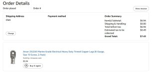

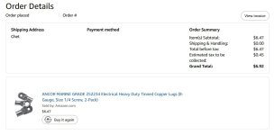

Early in the project, I tried listing the wire lugs I’d need, but the task was overwhelming. Instead, I purchased an Ancor 100-piece Tinned Copper Lug Kit and a 47-piece Adhesive Lined Heat Shrink Tubing Kit. These kits offer flexibility in selecting the right lug for each application, and I can easily reorder when supplies run low.

To minimize shipping costs, I ordered additional supplies, including 2-inch screws for fans and a toggle switch, which will be installed soon. These components will complete the control panel setup.

Originally, I planned to use the Victron Energy Smart BatteryProtect 12V 65A for another project, but after changing plans, it became available as a relay for the primary power wire to my Wallas Nordic DT diesel stove and heater. The Wallas draws 0.55–0.85 amps during operation but requires 8–10 amps for 5–10 minutes during ignition. The instructions recommend 10–6 AWG wire and states, “A main switch must be installed on the device’s positive (red) cord. Always disconnect power via the main switch after cooling is complete if the device will be unused for an extended period.” Since I had 8 AWG wire available, I used it for a one-foot run. The toggle switches I had were rated for 6 amps maximum, so I opted for the BatteryProtect instead of purchasing a 15-amp switch. This choice also allows me to monitor the Wallas’s energy consumption at various power settings via the Victron Connect app on my phone.
I used Ancor 8 AWG 1/4" screw lugs for the Smart BatteryProtect mentioned above. The convenience of ordering precise components online, with next-day delivery and no shipping fees, greatly simplifies the process.
