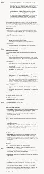

And finally, I wanted to take a moment to expose you to the power of Artificial Intelligence. My younger brother works at Microsoft up in Seattle and has been promoting AI for a long time. Recently, I began to play around just to familiarize myself with the process. When preparing to pose this update I had a great idea - how about provide Grok with a brief description of my planned electrical system and as a specific question regarding wiring.
I'm a mechanical fella so electronics are not my cup of tea but over the years I have struggled and when it comes to a 12 Vdc system, I feel pretty good regarding my understanding. Now answering a question such as the one I entered below would take me hours of research, pulling up system specifications from the manufacturers, creating a list of components, performing some basic calculations, checking my work, passing it over to a trusted friend for review, etc.
Grok answered my question in great detail within a few seconds. This system is somewhat infantile and with limited power. Imagine what will be at our fingertips within our lifetime? The great thing is AI can be used for good purposed but like any tool, it can also be used for bad. I was shocked at how accurately it provided this detailed answer on a somewhat obscure subject.

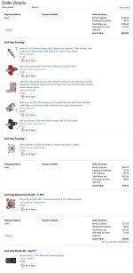

Here are the order details so I am able to track my expenses and use this information for reference purposes in the future. Notice also the fine Milton tire stem valve caps which contain an o-ring inside, very cool. And don't forget yet another 110 Vac plug, the correct mounting bracket (S-1163-22), and brass male nipples.

Here is an initial design consideration for the layout of gauges and control on the face of my Zarges box which contains all of my electronic systems. My goal is to arrange this using core principals of aircraft cockpit design - this would include logical grouping, hierarchy of importance, symmetry and flow, separation of systems, and accessibility. Of course, there will be trade-offs and possibly changes but here is my initial layout.
Right now I am assigning priority to the top row as a mission-critical, or power and health zone, in accordance with logical grouping. The BMV-712 will provide battery status, Inkbird is for thermal protection, and MPPT Control is for solar input - think hierarchy of importance. Using a top down, left-to-right scan, I will first check BMV-712 (status), Inkbird (safety), then MPPT (input). It’s a natural progression from overall power state to the conditions ensuring its reliability.
The next row down will be where my hands will be, this is kind of like a "master switch bank" where I will most likely install of a few toggle switches off to the left or right side. This is an example of separation of systems since this is where my hands can plug things in, remove them, flip a switch, etc. and not obscure my view of the critical gauges above. The DC voltmeter came with the package and is a minor gauge in this application.
As I stated in my previous post, I promise to make things interesting while doing things that have not been done before in this industry. Mounting all of the electronics inside a premium aluminum box, creating a pulse-width-modulated temperature control system for the electronics, arranging gauges and control on the exterior of the box to mimic the logic and layout of an aircraft cockpit. We are just getting started folks...still a man hears what he wants to hear, and disregards the rest...
