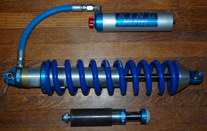

The Nitro 4.88 gears have arrived... so very shortly we'll be fully geared and locked. King Shocks is finishing up my first order, which includes some long travel internal bypass shocks for this rig. Pics asap.
