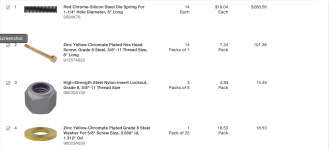

I'm not doing a 3 or 4-point. I'm doing a spring-mounted setup on my 2024 Chevy 4500 LCF (NPR-HD).
Just something I'm curious about.
This is what I opted for as well, seems much less complicated and easier to execute. Also easier to install / remove the habitat when I want. I have the solid mounts near the cab and the spring mounts slightly behind the rear axle.
The hardware and springs I'm using below if you are curious:
I disagree about that being simple or easy. You'll still be transferring stress to the subframe and habitat, but it will be less. And I've seen a few reports of people having a tough time getting that right.
What is the travel on that spring vs how far your chassis articulates?
