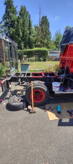

Hi There.
I need help with a subframe build.
In particular of what kind of springs to choose for my spring mounting.
I have a 2000 Mitsubishi Canter FG53EC with crew cab and a short frame.
The box I'm planning to install is 2.5m long and overhangs the frame by like 40cm.
I'm going to install two rails that going to run full length of the chassis and stop at the rear point of the composite box to properly support it.
My guess is the I have to bolt these rails to the chassis at the very end with side plates or u-bolts to the frame will work as well? Also I'm planning to use 4 spring mounting points towards the cab.
Now is the question. How do I size these springs properly, what hardware to use, what brackets? Can I just use two pieces of thick angle Iron as spring monts?
How did you build your subframe on spring mounts? What did you use?
Firstly, if you have not done so already, I would suggest that you search this particular forum, as this topic has been covered many times.
Basically, there is no "one solution for all situations" answer to your questions. A kinematic subframe mount needs to be considered as one part of an overall suspension system, not as a standalone component.
How you intend to use the truck and the weight of the habitat also needs to be taken into account. What works for me is unlikely to be an ideal solution for you, because we will likely have many things that are different.
If you have an engineering background that's great, but if you don't, speaking with an engineer could be helpful.

How heavy and tall is your box. This customer welded this to the lmtv bed. Solid mounted..The box is 12.4 x 7.4 x 7. Has been to Baja to Arctic circle

With such a short frame, the twist will be minimal. Body mounts with huge rubber vibration isolation may be all that's needed. About 1-2 inches of movement between subframe and truck frame.
If you're concern with frame flex I'd avoid a complex mount and bolt the rear of the frame with spring hangers going forward. Spring specs are an art and might require trial and error. The most complex mounts require actual engineering.
I did this with my F450 and it definitely works although I think my springs are too heavy as it really takes some tweaking for them to activate. I use the hangar and spring mounts from a water truck body supplier.
