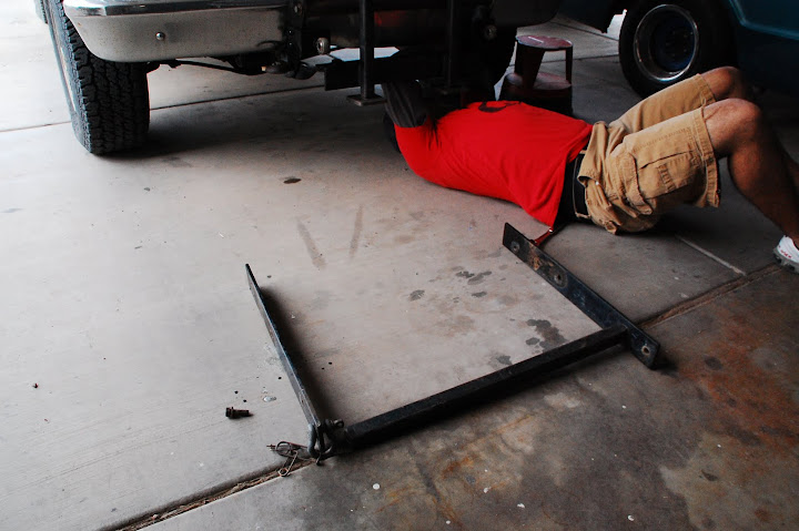

Well with the help of my brother in law it was time to do a little deconstruction and return to original on the old burb.
I put Alex to work unbolting stuff while I started in on a weird starting issue I had....don't we all hate electrical gremlins?

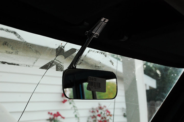

He did a great job of pulling out one of those mile wide, multi-pane rear view mirrors and installing this pretty puppy...and I figured out it was my neutral safety switch that was bad...at least dropping the column on these things isn't tooo bad. Oh and I gotta say having Vintage Ford & Chevy/Socal so close to my house is nice for me and bad for my bank account :)
Alex got back to the front end and just kept pulling pounds and pounds of steel off of it. My younger son is learning blacksmithing and really wants all this metal. I am thinking of buying a welder so he & I can learn to make all the bits we will want on this rig.
I am telling you the front of the rig was 1in taller after Alex was done shedding this stuff off the rig...I was not having fun under the dash.
Buy the time I had the switch on the column replaced he had already gotten rid of both side mirrors and put these originals one...much better.
This is what we left on for frontal protection for now...I like it.

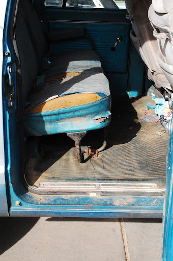

The windshield dude were finishing up as Alex & I started in on the nasty shag removal and figuring out how to get the big bad boom arm out.
The original vinyl flooring isn't too bad and will work till I gut the inside for sound deadening & insulation.
Now this is more like it and should give me a solid platform to start planning the inside buildout.
