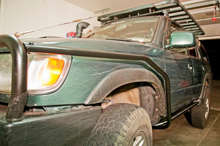

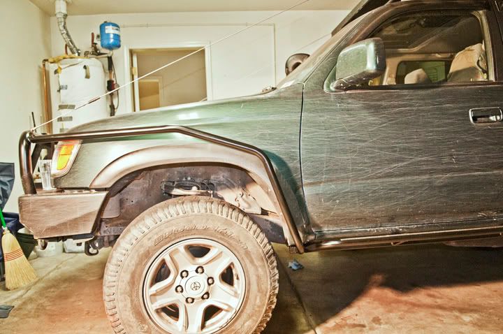

It has been quite a while since I have posted anything on my truck, but I really haven't done anything to it for quite a while. However, the last few weeks it has cooled off and I have been able to work in the garage with out melting, so I finally got off my butt and did some work to the old girl:
Crash bars or what ever you want to call them, tied into sliders

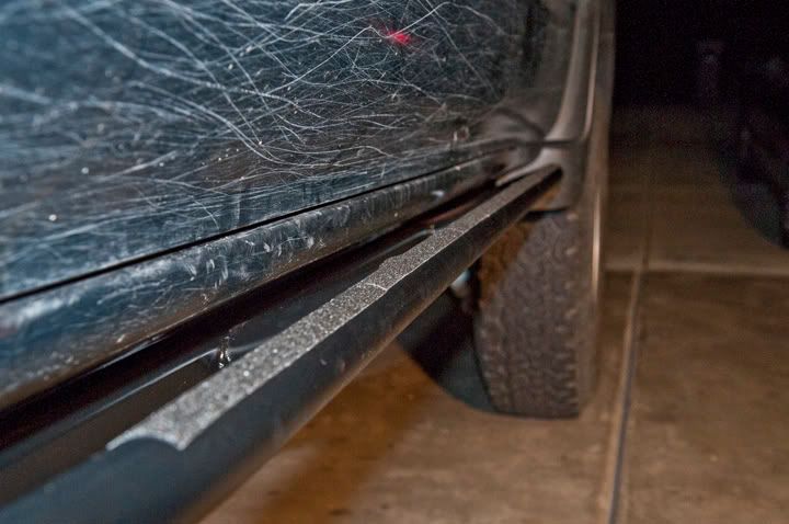

Non-skid along the top of the sliders to make it easier to use them as a step.

Some serious pinstriping there. Reminds me of my old tacoma in the manzanita :(.
Haha, yeah. People actually comment on the pin-striping before almost anything else. I'm rather proud of it too, shows the mark or a true field vehicle, not just something for show (no offense to those with shiny paint jobs still...) :victory:

are you still running the 235x85R16 BFG AT's? could you post a picture from the side so i can see how that size tire looks with the lift? thanks. Nice truck by the way.
Thanks! And yes, I am still running the 235 85's. I will try to remember to get a picture of it probably Firday (working 12hr tomorrow). If I forget don't be afraid to send me a PM or poke me with a cattle prod...
