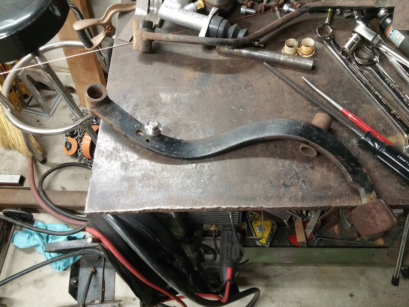

I finished up the master cylinder mount, and machined a post for the hydroboost clevis to attach to. Trying to preemptively cut out any sources of rattles so I designed it to have a wave spring to preload the parts together.
Where the post gets welded into the brake pedal:
Not entering the pretty welds post just yet :) First time welding stainless to mild steel, turned out OK.
In case anyone's wondering, McMaster P/N 1281N24 is a dead ringer for the brake and clutch pedal bushings.

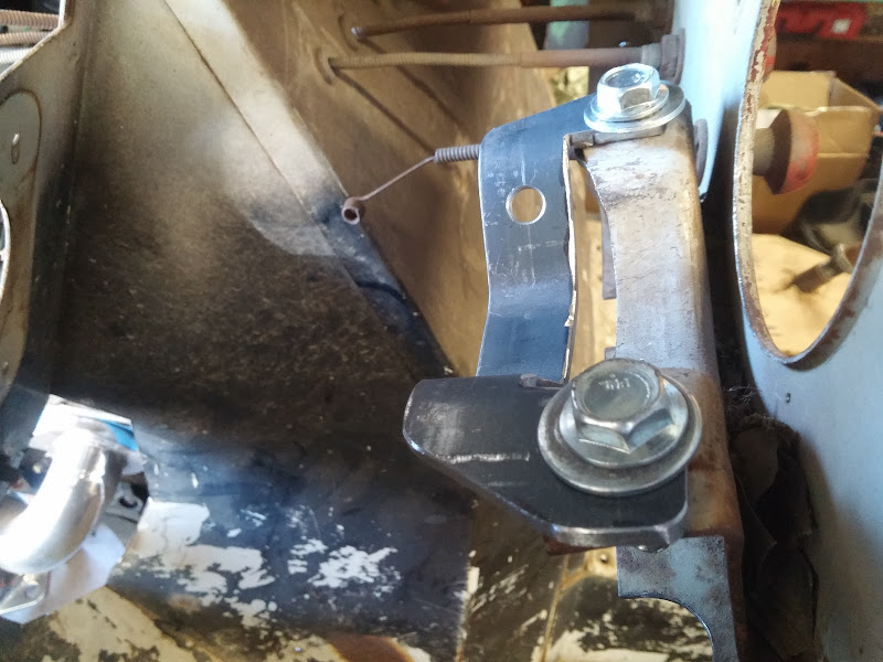

I got the brake pedal mods finished up, rebuilt the main pedal pivot with the above mentioned flanged bushings from McMaster, and got it all bolted into the truck. This let me figure out where the gas pedal wanted to be, and modify the Silverado Drive by Wire pedal to work. I used measurements off my DD Tundra to figure out where the pedal should be in relation to the brake, and it worked out pretty well. The brake and clutch pedals are in the stock location, adn there's still room for a dead pedal space to rest your foot - depending on how I build the cage this may get compromised a bit).

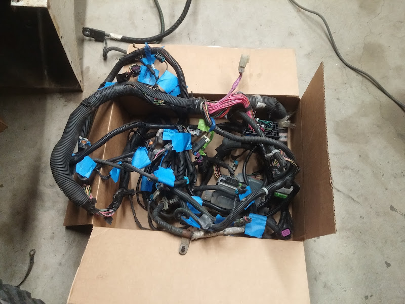

Next up was tackling the engine wiring harness. I went back and forth about sending it out or buying a pre-made harness, but in the end just decided to tackle it myself.
A few nights in the garage after the kiddo went to sleep got me from this
to this
to this
I used split braided loom (LINK), with self-fusing tape (LINK) to tie up the branches (the gray stuff - doesn't stick to the wires).
I'm happy enough with how it came out, and glad I did it myself - I have a much better understanding of what everything is and where it goes on the motor.
I used a lot of info on Brendan's website to sort out the loom, and had him program the ECU to remove VATS & emissions stuff, so I'll leave him a plug here: LT1 Swap
