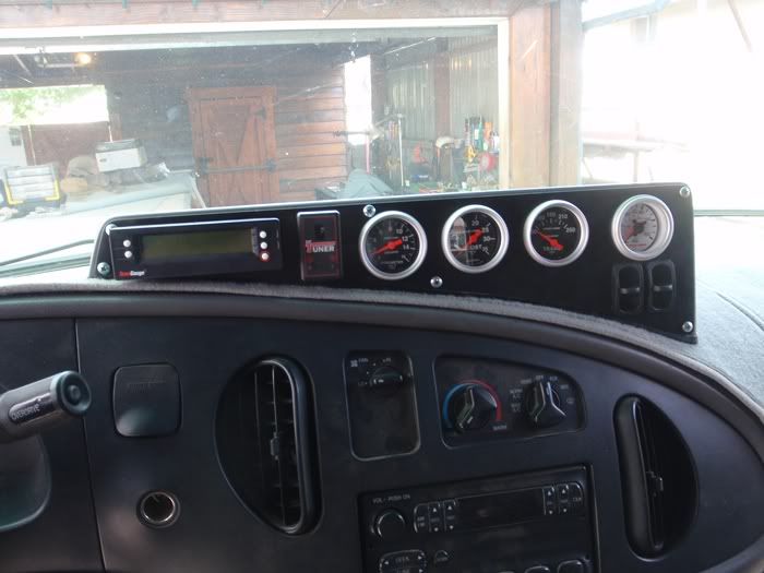

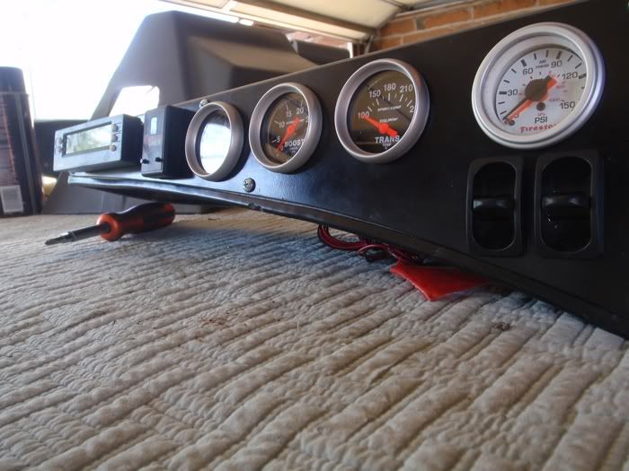

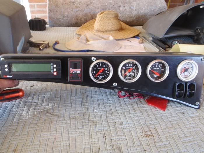

Gauges - The old ambulance switch cluster used to be here, made a new faceplate and loaded in the gauges. Scangauge, DP tuner, EGT, Boost, and Tranny Temp. Also the air guage for the bags in back, when the bags actually go in
All hooked up

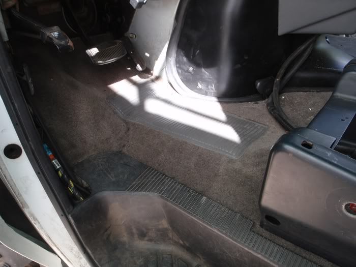

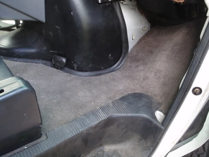

Found out when I took it Phoenix a month ago, that I needed a LOT of work on managing heat:

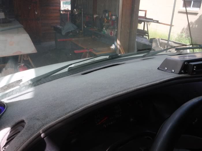

Dash mat

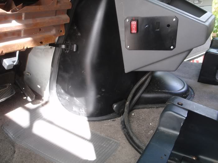

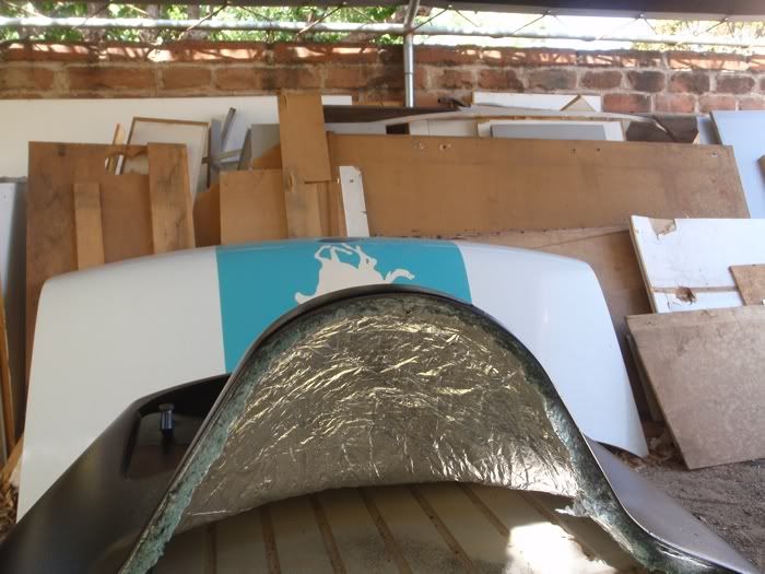

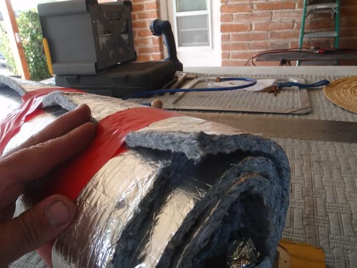

Insulation on the doghouse

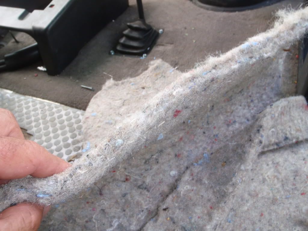

Carpet with the thickest padding I could find
Somehow I thought it was cleaner...

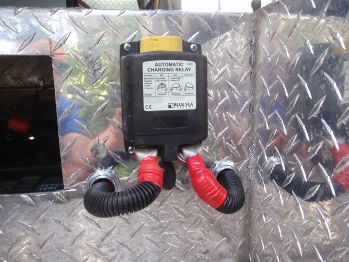

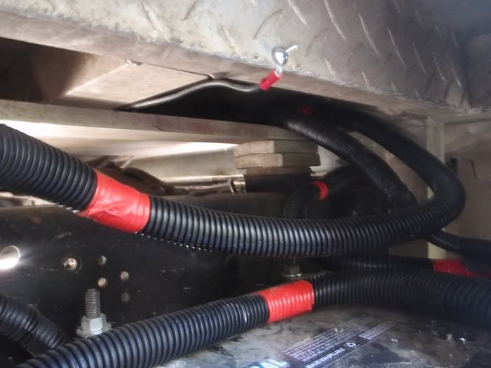

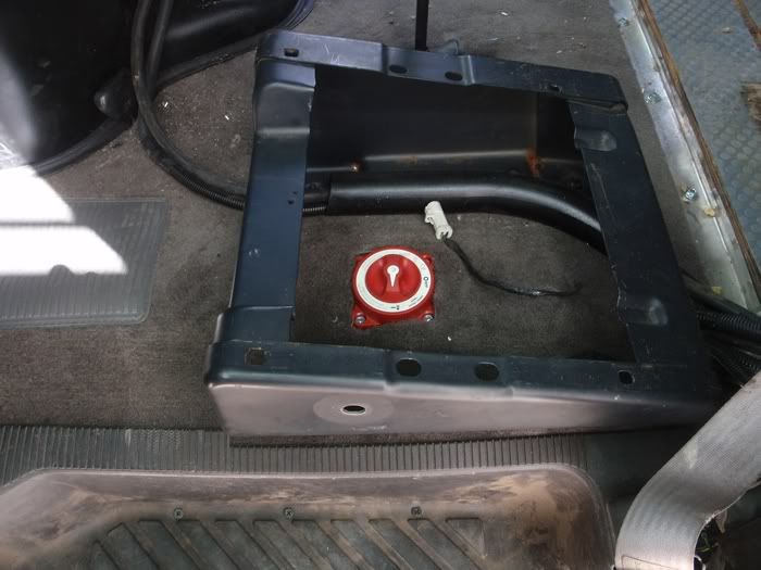

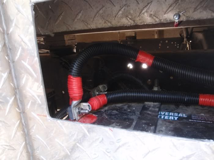

Getting the battery banks hooked up
Getting that 4/0 wire in there is like wresteling a snake
Charging relay remote switch
More electrical work - wanted to get everything that went to the dash, or to the engine compartment under the carpet. Anything else that goes to the new doghouse switch panel can run through the big conduit under the seat. I'll cover the exposed wires with something, maybe just one big split loom...

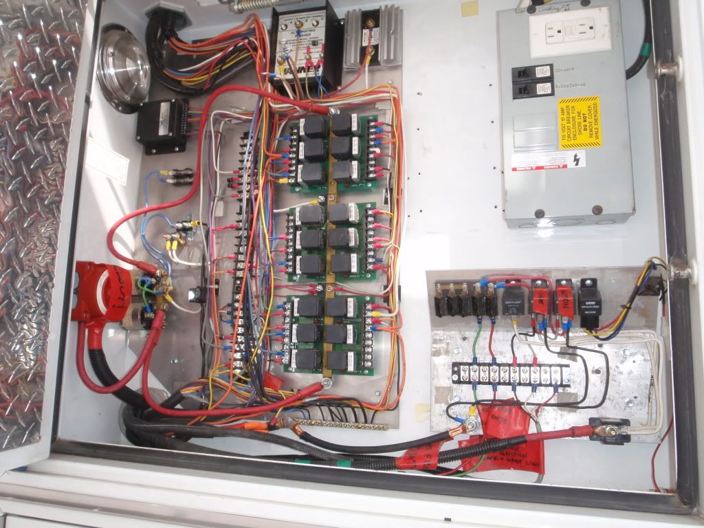

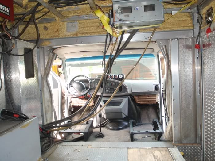

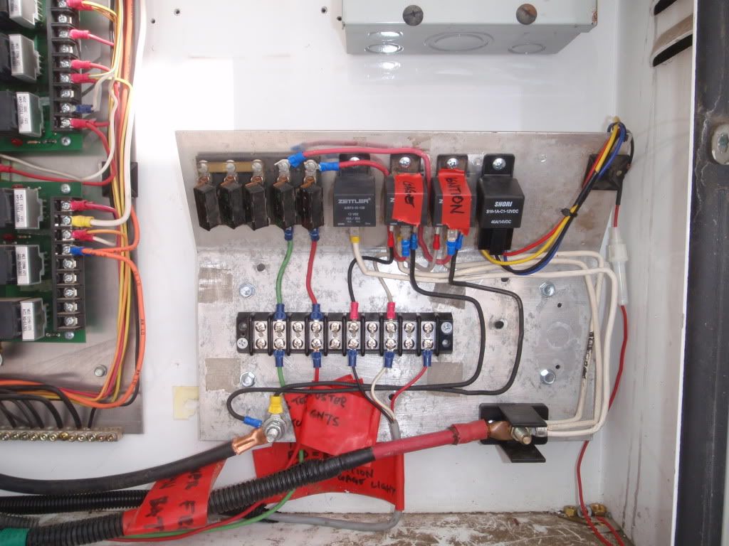

Starting to get the electrical room in order, pretty much have the van functions separated from the ambulance wiring -all that will be repurposed for coach functions, lighting, etc.
Still, there is a lot of crap in there

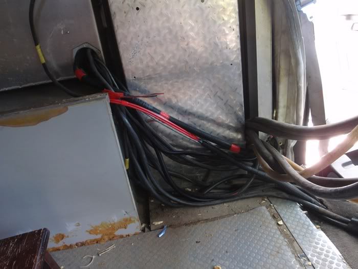

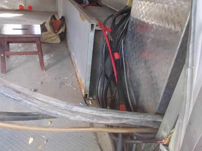

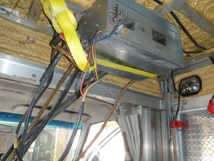

Battery cables, wiring, air lines, control wires, heat, AC, and condensate lines all run out of the cab at this spot
Next step, get the rear HVAC moved and set in its final location, extend the hoses as required.
Rear controls to be relocated to the side panel on the doghouse, also got a new electronic heater control valve to replacing the non-functioning vacume unit currently taking up space under the hood
Once I am sure all that is working, I can finally get the AC charged and functioning - Now that summer is about over.

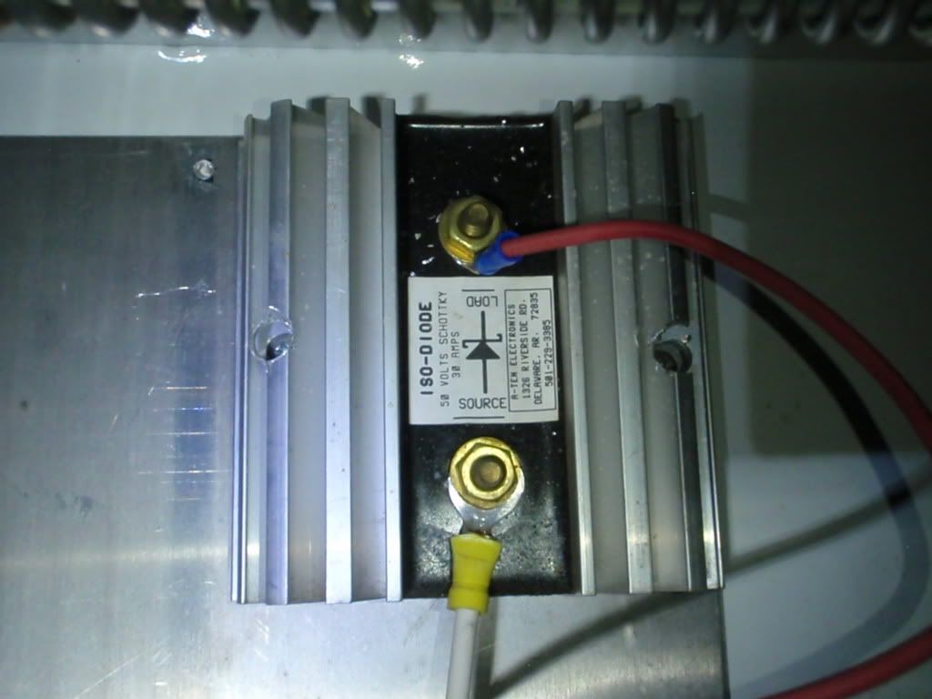

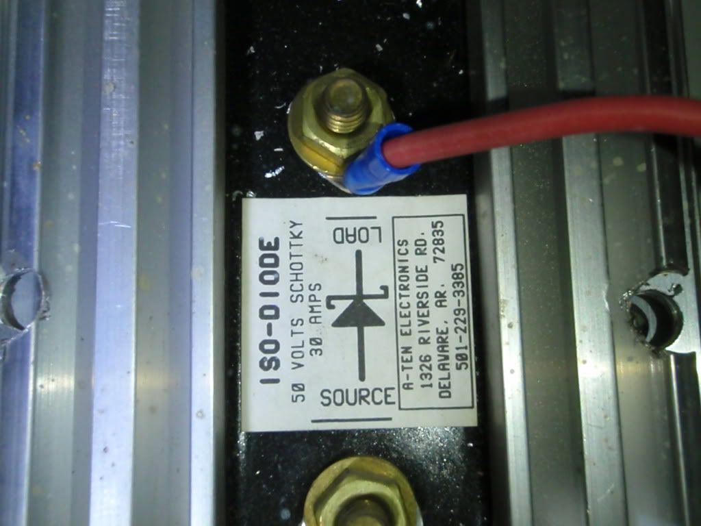

What is this, and what does it do?
Yes, I see it says 'doide'. It was run off a main power supply, and fed a 12 volt outlet. Why not just a fuse? (although it is a fused supply) Does this protect the battery from running down? Seems odd that it just fed a single outlet...
Is there any way a positive voltage could be applied to the red wire up top? My understanding of diodes is that they are essentially a check valve for electricity, allowing it to flow one directions but not backwards through the system if it could cause damage.
Is there any other type of power supply that could feed that 12 V outlet? Such as an exterior plug to connect to 120V or something?
That is what I dont get. No way for current to flow the other way, that I could tell. Also, the van didn't have house batteries before, so it is not like it is a separator. I was thinking it stops the flow below a certain voltage the keep the batt from going dead, but just a theory
And no, I never did consider just calling the number listed. I suppose I could just ask them!
Which way is it wired? To let electricity into the battery or out of the battery? Solar chargers use diodes (or equiv) to stop the solar panel taking a charge out of the batteries at night, maybe the outlet was for some kind-a charging circuit? I would say that it was to protect the batteries and internal electrics from what ever was plugged into that outlet, obviously the device in the outlet can both draw and create current so a fuse would not protect the van from the device so a diode was used, and a monster one at that.
