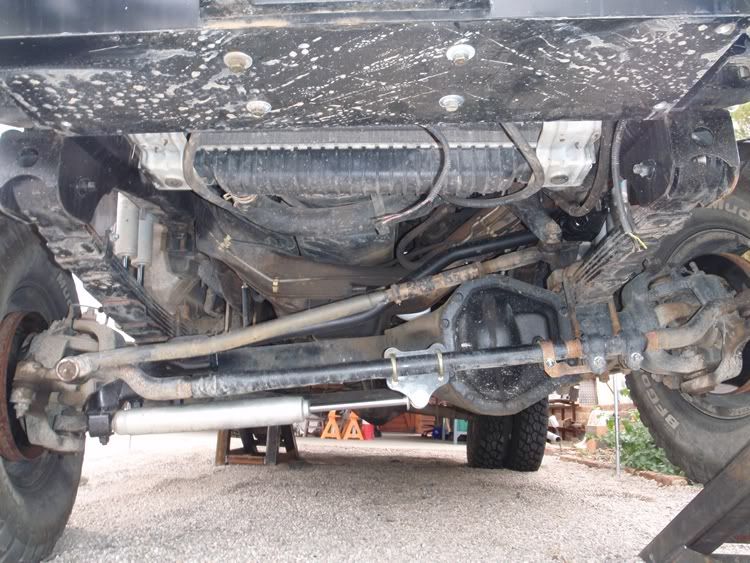

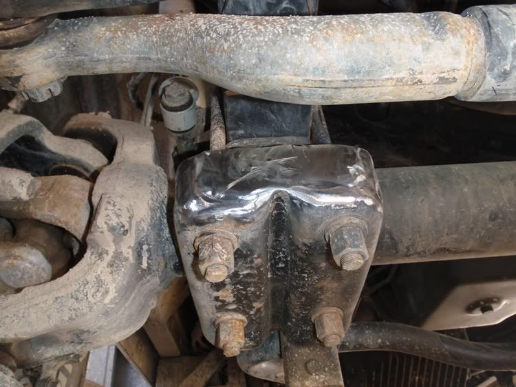

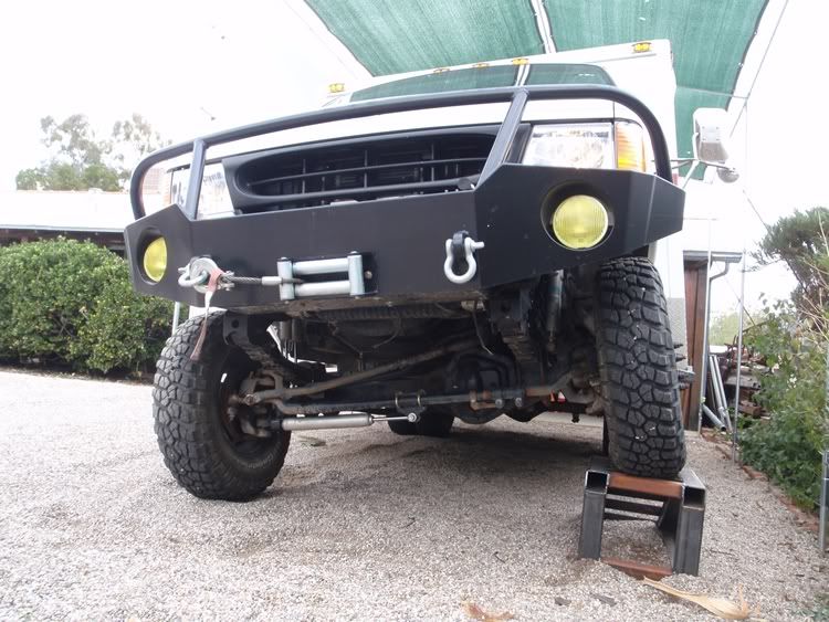

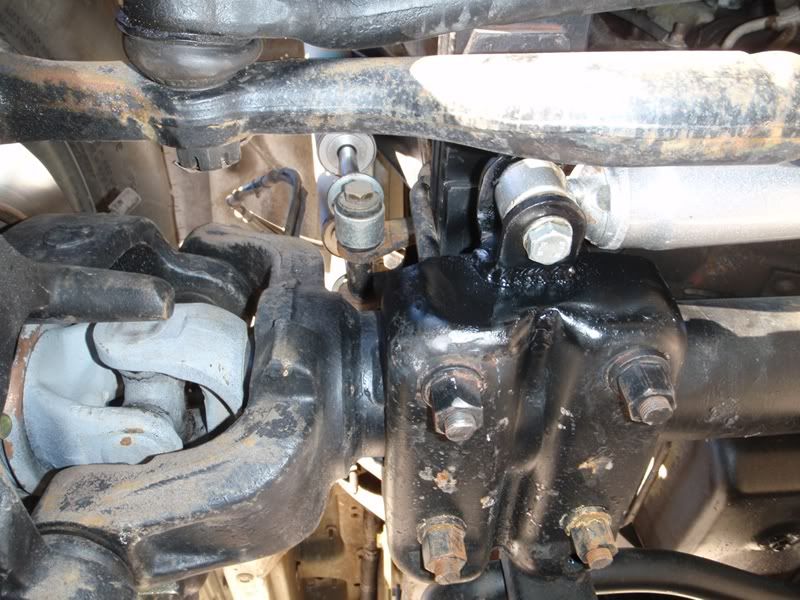

One of the last pieces of the suspension puzzle is Chris's trac bar assembly. I was very resistant to the idea of a trac bar, because it needs to be mounted at an angle, (not parallel to the axle) it necessarily drives the axle laterally when it cycles through it's travel - This is of course how it eleminates bump steer, because it forces the axle to move perpendicular to the steering linkage, instead of perpendicular to the axle itself. Because I was so sure I didn't want it, I chopped off all the components at the axle for attachment, and tucked the steering stabilizer up behind the linkage bar to protect it
Before trac bar install
However, I have only heard glowing reports of the performance of the trac bar when it is installed. I worked on my bump steer problems one step at a time, first installed the longer pittman arm, then put in much stiffer springs in back to fight the 'wallow', both of which helped. Finally decided to put in the trac bar in to get rid of the rest of the bump steer, and I can tell you it is awesome - there are no more 'tricks' to driving this, anyone can hop in and go - tracks straight, trivial (if any) feedback through the wheel from suspension movements, everything just works great now.
There are a lot of people that have this Ujoint system without the trac bar and they love it, not sure if it was the weight of my vehicle or just me that was bugged by the BS issue, but I see no reason now not to install it. It finishes the system.

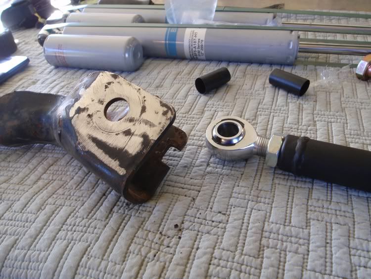

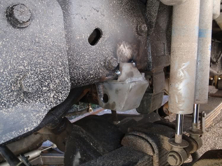

The bar and a new lower mount from Chris
Upper mount tacked on place
Prep at the lower mount
All installed
It does, however, put that damn stabilizer back down where any passing rock can demo it. ****** were they thinking when they put it there? I'll eventually try to find another location, but for now, I will just avert my eyes.

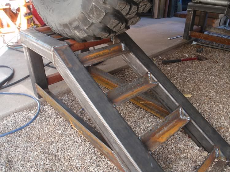

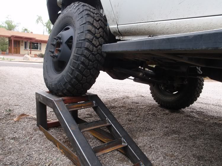

finally, a fun project, cleaned out some of the scraps in my steel pile and made some seriously burly vehicle ramps
This aught to hold it
Still a lot of travel left...

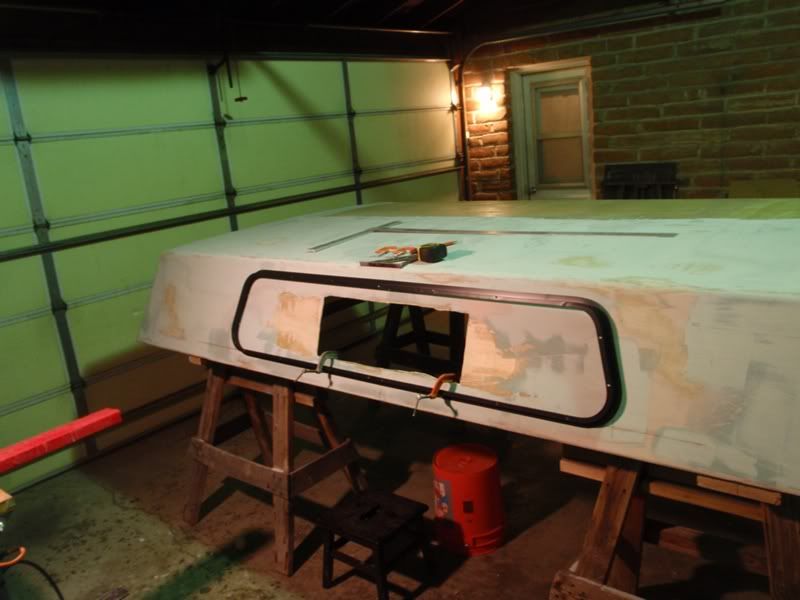

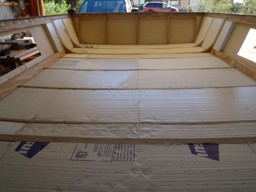

It has been pretty stuck at this point for a while, I is hard to do the sanding when there is something more fun to do. Within the next few months I want to get it done, the electrical crap is all out of the way, no more excuses there. I really want to find the right person to finish up the sanding/fairing/labor portion, that I can trust not to sand through the fiberglass, but wont cost me an arm and a leg for what is mostly just labor. I have a guy for paint, but he doesn't really want to spend a week sanding either.
Thanx for the pix. I'm debating the topper project. Would you mind sharing your plans?
Um, plans? What plans? I knew the overall dimensions I wanted, and sketched out a shape full size until it had pleasing proportions. I also knew how much room I need to have headroom in the rig. This was made into a template. So, no real plans. I made it 1 (nominal) foot less that than the roof size all around, and made it about a 30 degree angle on the sides. I would do it in aluminum or relatively light steel tubing if I had to do it again. I'll try this week to get the pics in the previous thread relinked, that will help with my process.
