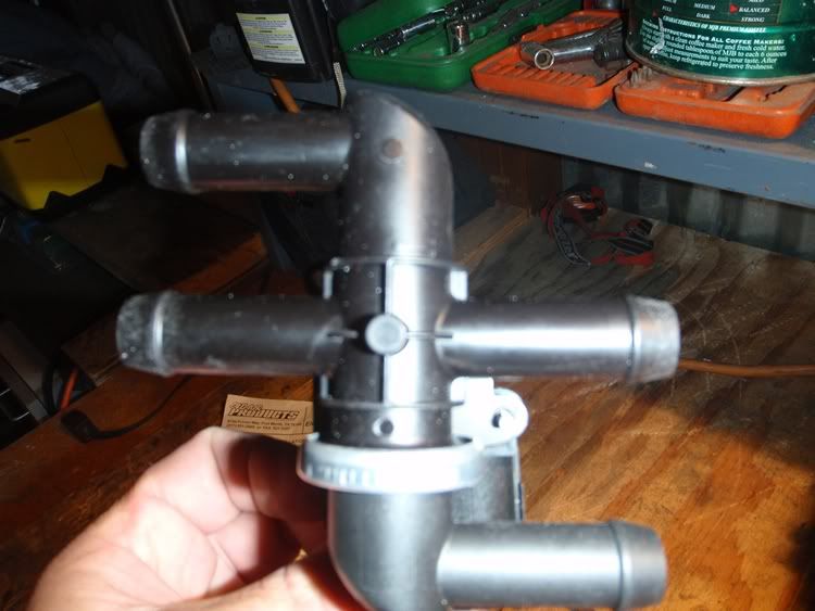

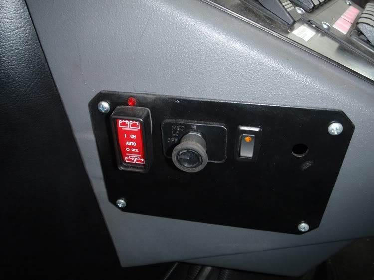

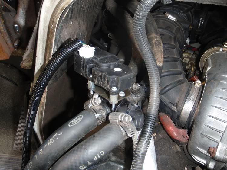

A while back I got the coach AC working as well as I could (one engine AC compressor only gets so far in Tucson in the summer...), but the coolant valves going to the rear HVAC unit did not function - which I found out driving it back from NC last winter. The vac valve just didn't seem like it was the best solution, so I changed it out for an electronic unit:
Pretty slick unit, although they could have used another foot or two of pigtail between the unit and the valve - no lengthening, it will throw off the valve settings
Put the control rheostat in the side panel of the switch bank, right where the hole is in this pic

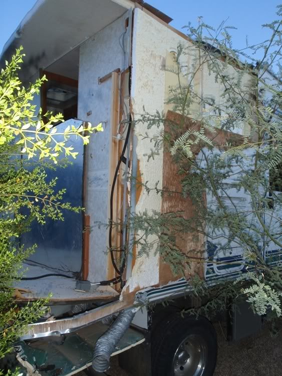

Extended the lines to the heater core
Had to do a bit of rebuilding of the sheet metal box the heater/ac unit is in, here is a pic of the area before I extended the lines - It will live all the way to the right, by the door.
A bit of a trick to get the air out of the lines when I was done, had to get the engine warmed up, start to pressurize the system, and back off the hose clamps to the heater, while holding it up to be the high point in the system, until all the air got out. Now I have fully functioning rear heat/ac, seems like a while to get here.

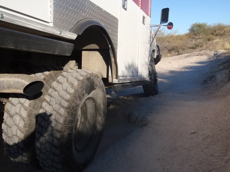

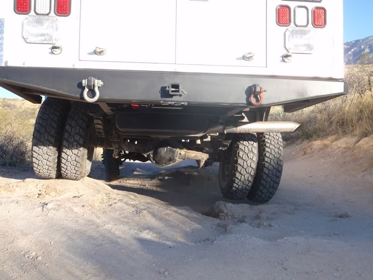

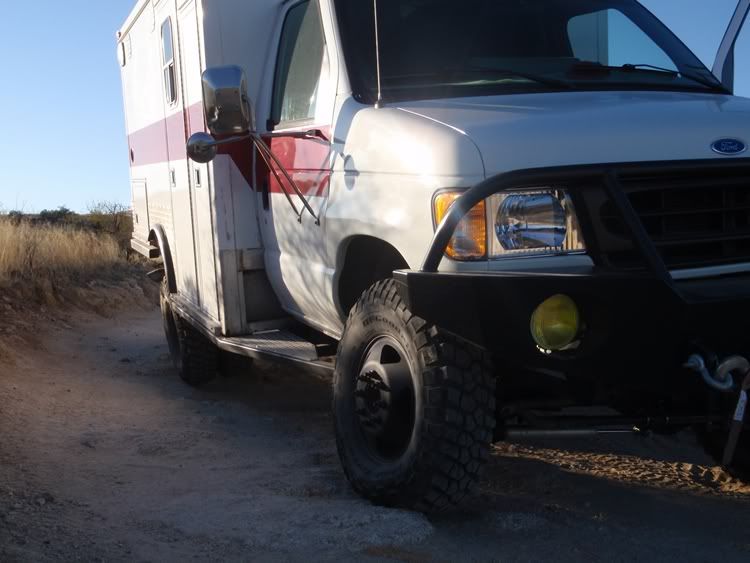

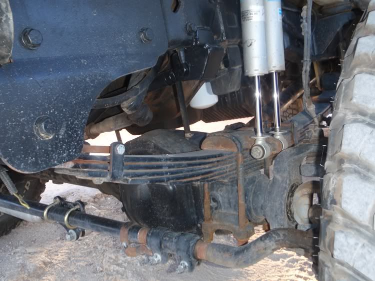

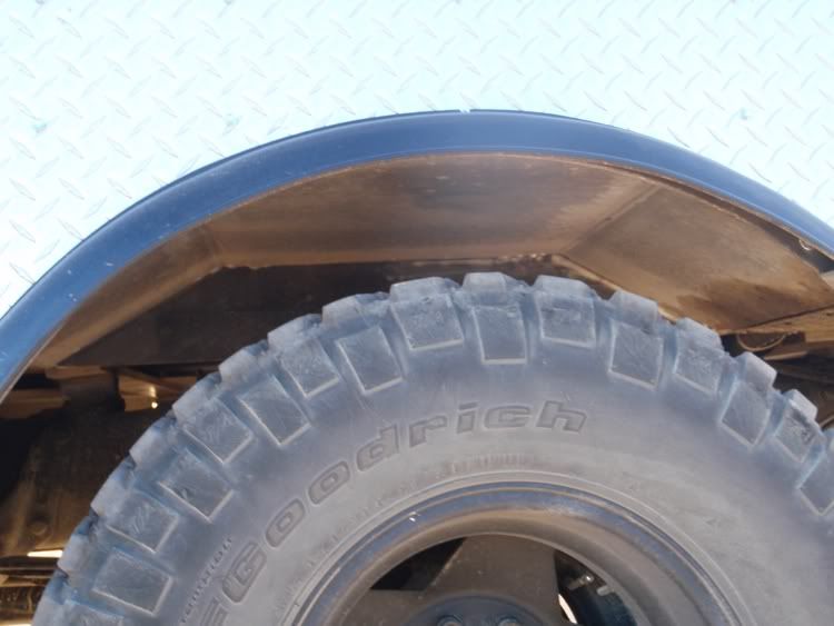

Had to take the rig out to Chiva Falls to celebrate, and to bounce the new springs around a bit - Not quite as much articulation, especially with it empty, but no bottoming out, and very balanced front and rear
Last time I went out, when fully twisted up, the wheel was jammed against the top of the wheel well - much more cushion now
Trac bar mount holding up fine

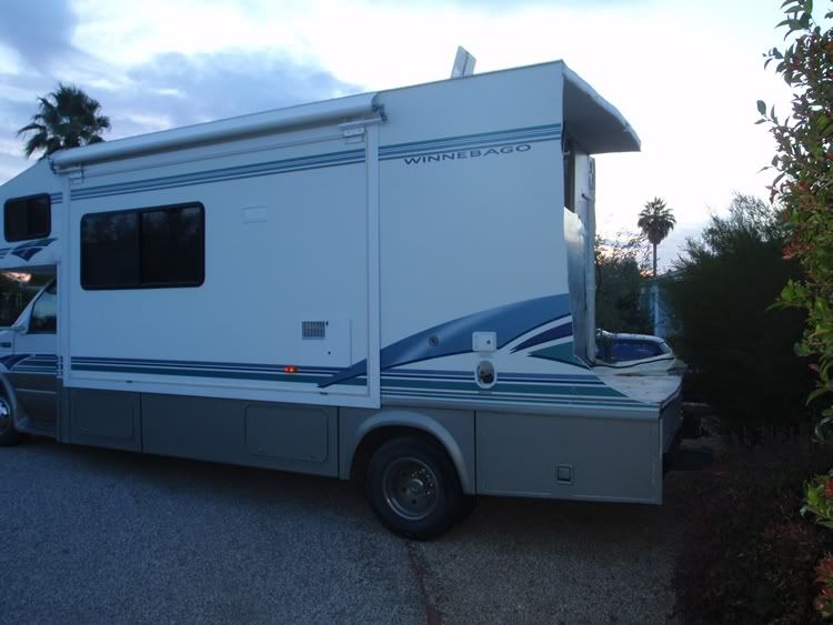

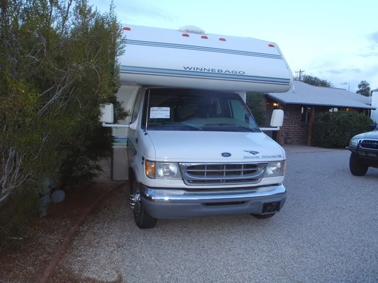

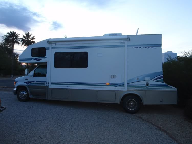

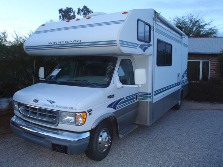

And, very excited about a new doner vehicle - I must have been a year ago I told my wife as I was scouting the interwebz for seats that wern't spent, some proper mirrors, interior trim pieces, plus all the little pieces that an RV will need, that somewhere out there is a nice class C motorhome that has been rearended by a semi, got totaled, and is full of all the stuff I need. Sure enough, it was true
Almost looks like nothing is wrong from the front
A bit rougher on the passenger side
99 E450 cutaway chassis, only 30k miles on a v-10, I drove it home! Runs awesome! I paid $3000 for the whole thing - Heck, I can get almost that much for the engine/tranny. It has all the RV stuff, a fully functional drivetrain - even has an dually axle with disks, plus power windows/mirrors, and all the interior trim pieces that are battered on mine - Seats are in great shape, I'll just be able to swap the whole cab doors over intact, I'm a little giddy.
I made a deal with my dad to keep it on his property until I cut enough of the rig away to fit it in my alley - I'll park a roll-off dumpster next to it, and cut until I am down to a flat bed, and it can park in the back without sticking up above the fence - I'm already in danger of becoming 'that guy' in the neighborhood - Luckily the neighbors think it is a cool project, but parting out a full size RV might just push them over the edge.
