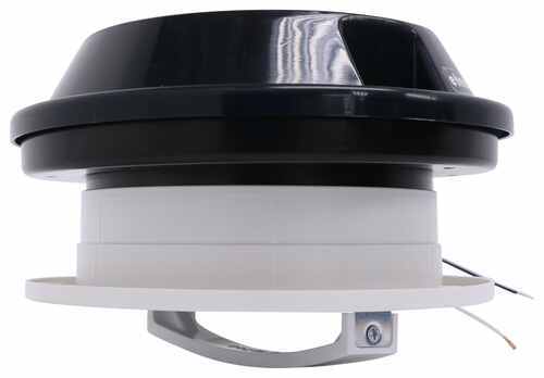

Regarding ventilation, has anyone had success using existing ambulance vents? Would you be able to compare with the noise/efficiency of something like a MaxxFan rooftop unit?
I'm working with a Type 2 Ambo, 94 Ford e350. It is setup with 3 vent fans (drivers side rear, passenger front & rear), all the Atwood Turbo 3000 3" Blower Fan. These are just too noisy. If I replaced them all with similar (quieter! & efficient) units, how effective of a circulation system could be created? Any suggestions on specific fans to consider? Maybe adding pop-out windows to help too?
I don't want to interrupt the look of the ambulance with a rooftop unit, but I have a dog and must maintain proper ventilation when leaving her inside.
I put a ventline vanair fan in the back of the two vents on my roof. It’s small and runs at 100cfm. I had planned to add a bigger fan to the front vent. Small and low profile. May not be enough for you depending where you’re parked and what the weather is. Nice and low profile when closed though.
