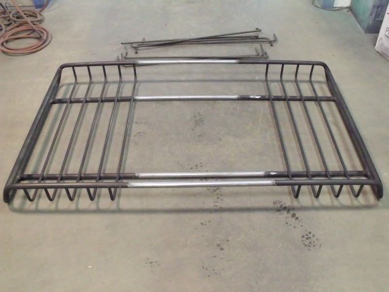

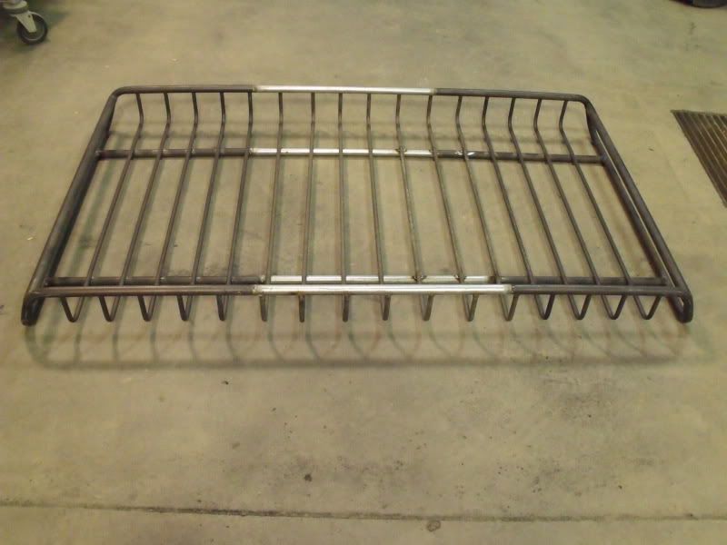

New rack configuration
So I've decided to change my roof....well, over the bed, rack. My current rack is too heavy for the small amount of cargo capacity it offers. I picked up a Yakima Load Warrior for super cheap and have set off lengthening it. It was no bigger than my other rack but a lot lighter.
I had a friend bend some ribs for the extra length.
Even with the extra length it still weighs less than the old.
I'm going to run some 1 1/2in square tubing down the sides of it to give it the strength it needs in the mid-section, and put tabs on it for mounting. Hopefully it will be completed by the end of the weekend.
