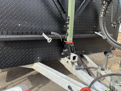

Aaron has been just as helpful as every describes here, and his sub Matt was equally as responsive. We'll be using the Alto Superior 45 rack with adapter that was mentioned to fit 4 bikes on there. That option (hack) was one of the must-haves for us that sealed the deal for Arkto v. Boreas. But I also prefer the side entry and interior set up of the Arkto. And now that we can get the 900+Ah batteries, and 1kW panel set up, the decision just got easier.

Alta racks rule

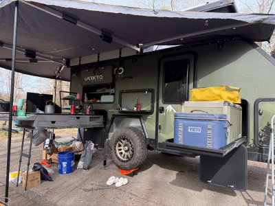

We got our G12 a few weeks ago and are loving it. Arkto customer service was exceptioanl as expected, and the trailer was easy to tow, easy to set up and really comfy on our shakedown trip in temps below freezing. We have 600 W solar array, and 960 Ah of battery storage. In 3 nights, 4 days, we got down to about 70% battery, running as much hot water as wanted, and heating to 55 deg all night. We used about a third of a 30# propane tank, I think. We have a gauge but it's not really clear how much of the total is used.
It tows very smoothly but we are maxed out on the GCVR of 10800 (6200/4600) even without carrying water. I like having a mid size truck on trails but towing and load capacity is a limitaion for sure. And we got about 10.5 mpg on mixed driving, from 55 to 75 mph for 1.5 hrs.
The interior and overall usefulness is really great. Storage is as expected - phenomanal. The OVS awning is effertless to deploy, but a work out to get back into its duffle. This should get easier with pracrice I hope. Its coverage is really good and gives plenty of living space. The OVS shower tent is good but you have to secure the base pretty good or it blows around a lot. Its unfortunate that the entrance to the shower is diamtrically opposite of the awning cover meaning that you have to go fully outside of the awning/trailer environment to get into the shower/toilet tent. OVS should make this more configurable, but it's also due to the fixed location of the Arkto shower connection access built into the wall.
One trade off we made with our preference for outdoor kitchen is that in extreme temps we have to close up the kitchen slides at night to maintain the insulation efficiency. Sounds obvious when I write this, but wasn't something that I had considered. Once the G12 is closed up though, It's quite efficent, dark and quiet. The Truma AC and heater worked very well.
One of our base requirements was the bike rack. We got in contact with Alta Racks from this forum and Arkto who have this custom hitch adapter for their Superior rack system. We have Superior 45 and it is mega. Super steady and stable, well built, and easy to order from Alta. It's bit of a lift to get a 50+lb e-bike into the rack but it can be done. A regular modern CF MTB is no problem.
The tare weight of the trailer is 3500 lb or something like that, with max of 4600 lb. But once we added up the various options weight - panels, batteries, bunk, insulation, bikes, etc, the available cargo weight quickly approaches zero. It leaves little room for water, food, toys and such. Point being, there a lot of storage volume here but not an equivalent weight margin for typical camping rig. Not a problem if you have a full size truck, but for our mid size ZR2, we quickly got to GVCR. Our truck has an added leaf for +750 lb of support but it still sags a couple inches and doesn't add to the max GV capacity.

We have 600 W solar array, and 960 Wh of battery storage.
Congrats on the trailer! Pretty sure you mean 960 AHr of battery ;) which would be 11,520 WHr. Did you get AC as well?
The space : payload ratio is, definitely, something to be aware of! I brought that up to a lot of folks while working at Expo East. You can EASILY overload one with so much room for activities!
Right, Ah, doh! we did get the Truma Saphir AC and used it on the first night out. The weather turned and we used the heater on the next couple nights. Really slick and really efficient.
