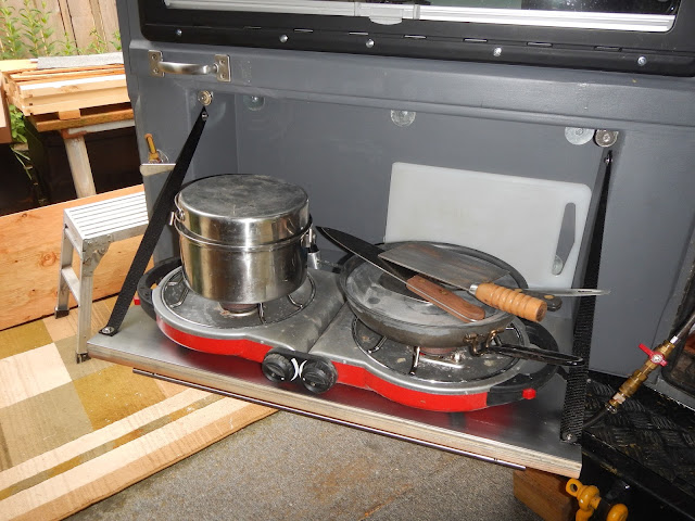

I finished the folding table for the JK fridge slide today. Anyone up for a picnic?
Here it is without the traditional Gingham tablecloth :)
Stowed. The table folds up between the fridge battery and the fridge.
To show how it works, here's a deployment video:
The leg that supports the outboard side of the table is a "monopod" intended for cameras, they're cheap, light and adjustable. It attaches to the bottom of the table with thumbscrews - I made it removable to minimize the thickness of the stored table.
And how it stows:
I've still got a few features to add, stay tuned...

Thanks Donny. My goal was to provide enough table space so you don't have to carry that extra table anymore and have it take up no more space than the fridge alone does. You can let me know if you think I've succeeded when you see it in a few weeks. BTW if you've still got the hardtop on I'll bring a Freedom Panel with a pop-up skylight we can try out too.
Thanks!
Definitely bring the freedom panel. I will not be removing the hard top at all with the Gobi rack on so you are set. I am interested in seeing the table space. Just watched the video on work computer so I could see it better. Man it looked nice! Again Great Job!!!

The next feature being be added to the fridge slide/table system - a panel that attaches to the fridge tray so it slides out with the fridge and has slots for attaching Molle gear and bolt holes for either a Rubican or a Rotopax container to keep water close to the food prep area.
Today I made up the panel. As soon as I paint it I'll post photos of it with Molle pouches and a Rubican water container mounted.

So what you're saying is something like the panel I posted a picture of, but only mounted on one slide instead of being on the side of a tray that's running on two slides, right? Weight wouldn't be a problem, slides are available up to 500 lbs. per pair, so I think 250 lbs. capacity for a single slide is quite a bit more than the weight of the gear you listed. What' I'd worry about is the side to side stability of a single slide - there's some amount of play in a slide, and I suspect a vertical load on it might sway from side to side when the vehicle was in motion. Might be that a pair of slides mounted fairly close together would be a better way to go than a single slide, although it would be worth testing a number of different slides to see if one could be found that had very little play in it. No reason why a fold-down table couldn't work on a single slide, what I've built would easily bolt up to a single slide and work fine.
Yes a panel like you posted. The side to side stability is what I was wondering about, using 2 slides close together could help solve that.
For me a slide out vertical molle could be handy, I already have a tailgate table in my JK, I was thinking a drivers side table could be useful for someone who already has something bolted to the tailgate like your storegate.
Ive got a JK so if I got a fridge it would go on the rack outside the gate and not on a slide inside like on your JKU.
