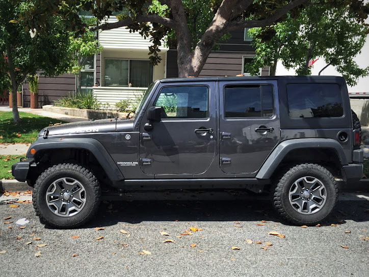

I installed the Teraflex 2.5" Budget Boost and the AEV geometry correction brackets yesterday. I got a good deal on a used Teraflex spacer lift, but it turned out to be missing the rear brakeline drop brackets, rear longer swaybars and front shock extensions. I ordered those. All considered I still saved a lot of paying retail. But at this pricepoint, I probably would have gone with the AEV 2.0 lift. The tF one allows me to run 35s in the future though so I don't have to do tires and AEV 3.5 " lift at the same time anymore.
I've installed about a dozen lifts and this one was by far the most painful to install. I also installed the AEV Geometry correction brackets, which was a major PITA trying to get everything to align because the Evo Protek crossmember skid also uses the DS LCA mount. I ended up dropping the skid to get everything to fit. I still have to go back and install the missing pieces when they arrive on next week, as well as cut out the rear spacers' cones, they're interferring with my airbag suspension in the rear.
Overall I think this is a good lift height for the stock tires. 2" rear / 2.5" front. The factory suspension isn't bad with the rear airbags to stiffen it up. And the extra clearance should save my underside some. Here's to hoping this holds me over to until I can get the real deal this December.

The 2.5" lift is close to how mine sits now. not much difference at all. Looks great. hows the handling with the drop brackets?
heres a shot of mine with the 2/1" leveling kit with 33's. I can't see too much difference....
It looks taller in person. I think I'm done doing my own work though. I hate that feeling afterward where you second guess if you tightened everything to spec. My perfectionist side wants to do everything by the book. But that's hard to do when you're laying in the street. I think on going to get a buddy's shop to install the next lift. When I built land cruisers there was a desire to learn how to do my own work. Now I know how to and don't want to.
