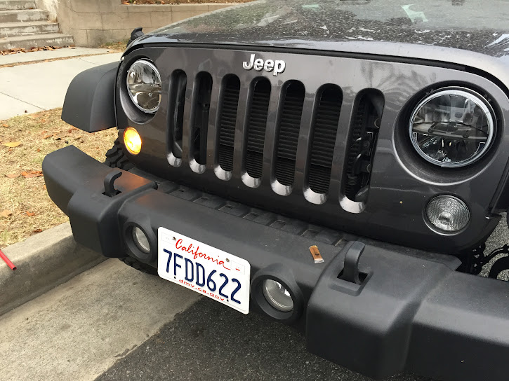

Installed these bad boys tonight with the anti flicker modules. One of the last sets from Northridge at the lower price. I don't love how much they stick out of the housing. I wish they could look like OEM but be LED. We'll see how they do. I had to add electrical tape to the Driverside headlight to get it to fit snuggly. They also seem slightly smaller than the OEMs.

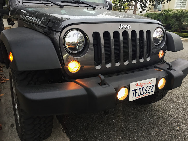

Does anyone know why my parking lights are staying on while driving? And after locking the doors. Does it have anything to do with the anti-skid light being on on the dash (which I think is on because the steering wheel is slightly off center after the lift)? I tried to recenter the steering wheel yesterday but ended up turning it the wrong direction. Hopefully, I corrected it today and the light will go off. Also, now the PS parking light is brighter and staying on but the DS one isn't.....

Did you accidentally program the lights as DRLs with the procal? Maybe delete the DRL settings with the procal and see if they go off.
Tried that today actually. Now just the PS one is doing it.

If only the right turn signal light is on it may be that the steering wheel centering test with the procal was not exited correctly. Might want to double check. Did your ESP light go out?

OK, I just re-read the instructions, and saw the part where it says "Be sure to exit the mode properly by enabling either turn signal before removing the module."
So, if I understand correctly. Center the wheel, then turn the turn signal on left or right, before unplugging the Procal module.
It also says that if a clean exit was not done, just plug the procal module back in, enable the turn signals, and then remove the module, or just disconnect the B- battery cable.

Scott, that worked for turning off the blinkers. The Skid light is still on. I wonder if that has to be reset with the battery.

If you set the Procal dipswitch 1 and 4 up, with all the rest down, it will clear any trouble codes that don't have an active fault... according to the guide.
Might try that first, before disconnecting the battery.
I ran a diagnostics through the OBD port last night, and didn't get any codes either.
I get the feeling it would require a real scan tool, like the dealership software or the professional shop gear.
So I'd try those two things, and then a good google search.
