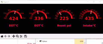

Long post pending, the image above is a gauge coded for a Raspberry Pi, to work as a digital dash for the EGTs, Boost Gauge, and Intake temp.

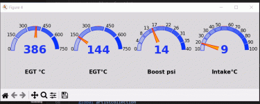

The biggest question I had was whether I could build a digital dash that updated in real time, and showed the graphs with useful data. Here is where it is a presently - the dials move around randomly because I have a sensor emulator running that simply generates random numbers.
Daytime Screen:
Night time screen (I know the numbers and dial don't match on this):
You will see on the bottom of the above image that the CPU usage is shown for Python. The original concept that I coded was only capable of 1-2 second intervals (refresh) because it was rendering the whole screen each time. It maxed out the Raspi's processor and crashed at full noise. The program now uses blitting, so the only data being updated on the screen is the needle, and the digital readout, the remainder is set at initial start-up.
If you are wondering why the two different screens, the red readout can be on at full brightness at night and only marginally reduce your night vision, but it is harder to see during the day, especially with sunlight on the screen. The daytime screen uses blue with light grey to give a high contrast image without unnecessary glare (such as from white background). There is an interesting discussion here if you want some more information: https://ux.stackexchange.com/questi...sitivity,produces the highest visual contrast. I tried the black with yellow, but where you have a screen that reflects light from its surroundings, yellow seems to be affected more than the grey.
