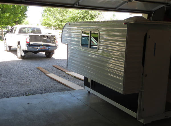

It's Launch Day!
Loading went easy, took me awhile to work out the tie downs, but then went on a short test drive and feels solid. Going to the DMV tomorrow and I plan on taking it to the scales on Wednesday.
always been curious, how do you seal / finish between external siding and window frame or lathes on the corners ?
as siding it's not a flat surface do you have some special shaped parts to fit siding pattern or you just don't bother and use silicone like sealant :)
could you show close-up of your window ?
wow! you've got some skills man, great job! A+ :ylsmoke:

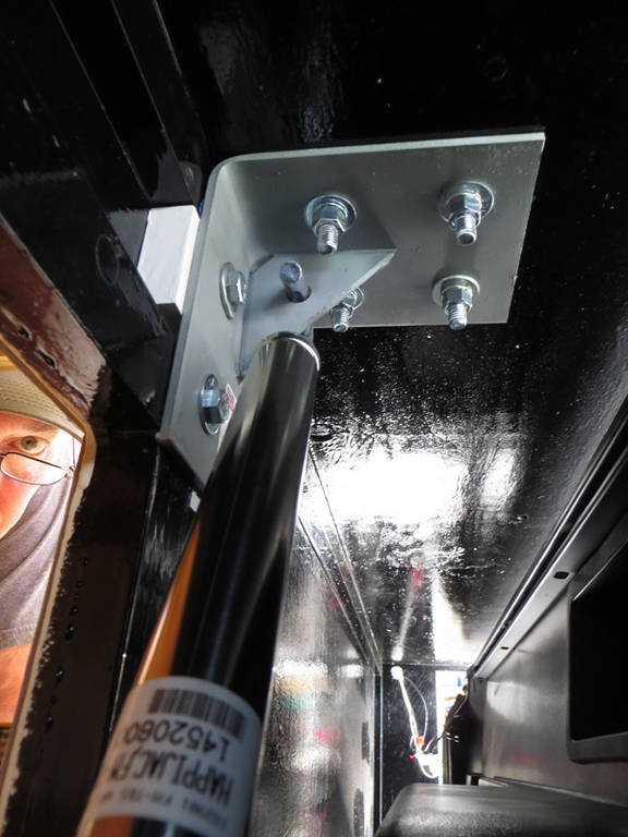

How do the tie-downs work?
Also how is it that the side wings don't collapse under weight, are there some angle bracket under them?
The front tie downs connect to brackets in the bed of the truck I installed using the front bed bolts and I added another nut under the bed and to Simson brackets attached the the camper using 8 bolts, since the box sides and wings are only 3/8" plywood. I used the Happijack spring loaded tie downs.
I ended up rotating these 180 deg. as I notice when I had something else tied they started to rotate on their own.

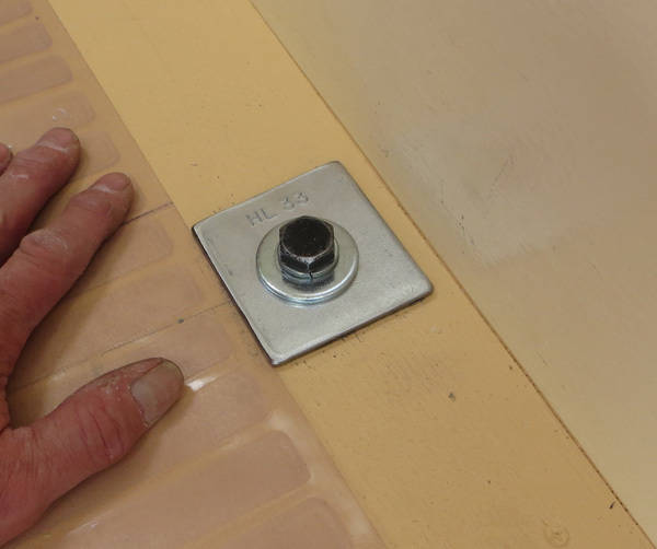

For the rear mounts I replaced the stock bed bolts with 180mm long bolts that go through floor of the camper in to the frame of the truck. I added extra nuts under the frame for these bolts too.
