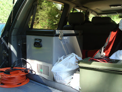

Plus it fits pretty good in ..... a 100s land cruiser...
