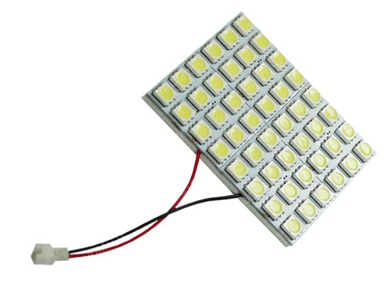

I put some SMD led panels in mine. I couldn't get them mounted well so I went ghetto and just glued them to the insides of the lenses. Mine are old and a little dull so you cant really see them too much unless your looking. They are VERY bright with two panels in them.
I used something similar to this:
Mounted to a strip of aluminum and glued in with 5200
