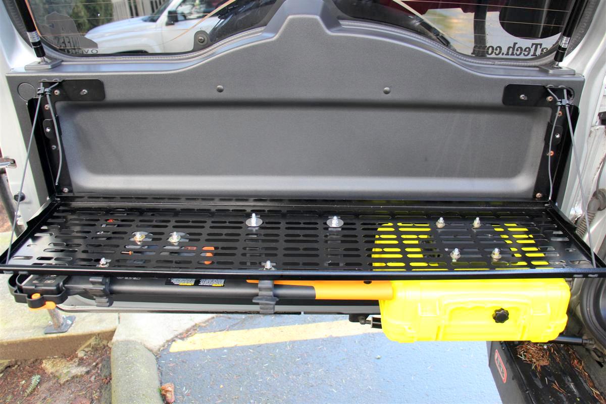

As you could see from the previous pictures, when the chuckbox was pulled out there was not much room to stand when its door/table was in the down position.

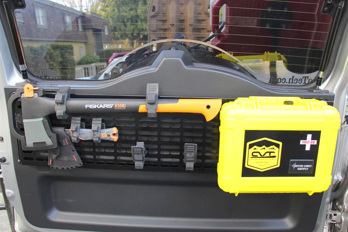

I would have had to dis-mount the Outer Limits Weekender first aid kit to stand there, and it would still be tight.
Rotating the chuckbox 180 degrees so it opens on the passenger side the door would not drop down due to it hitting the rig inside by the tail light area.
I got a hold of Jerry at Tembo Tusk and asked if they had longer Accuride slide tracks, and why yes they do.
He had to order in a pair of 35" ones for me, drill a few new locating holes. and ship them out to me.
He had detailed instructions for removing the original ones, and mounting up the new ones, so it was a very easy job.
Now when I pull the chuckbox out, I have room to drop down the door and use it as a prep table facing it from the passenger side, very nice.

I did have to cut the tray on each side with a hacksaw, as the ends of the rails butt up against a lip, and the longer length of the new rails would not work, unless I wanted to use the upper mounting holes, but that would raise the tray the chuckbox sits on about 1/5" higher, so I opted to notch the lip.

Showing the door/table not being able to drop down all the way due to the stock shorter slide rails
New 36" rails in place
Shot of the chuckbox tucked away, same as before
Shot of it from the rear closed, it comes out about 8" more than before
With the door/table in the down position

I cleaned out my interior which needed it badly, and was organizing my cargobox a bit, and I spied the plastic tent stake hammer in there that I have been wanting to move to the rear door fold down rack/table.
I had some more of those mini Quick Fists like I used for the small hatchet, but they were too small.
I also had two more pair of the bigger ones like that hold my Fiskars axe to the rack.
Perfect size, and now I do not have to dig through the cargobox when it is hammer time for pounding in stakes for various camping accessories.
This hammer also pulls out stakes too.
I have had the hammer since the late 80s when I use to backpack around Mount Rainier.
Light weight, and it does a great job, even on bigger heavier stakes.
I had bought it at REI, but Amazon carries these too.
Links:
Original Quick Fist Clamp for mounting tools & equipment 1" - 2-1/4" diameter (Pack of 2)
Coleman Mallet with Tent Peg Remover
Pics:
Used the new 1/4" bolts, Nylock nuts, and flat washers that I had bought for the installation of the Tembo Tusk fridge slide to the top of the Goose Gear cargobox
Quick Fists rule
It is a great fit indeed, and much more easy to get to now
