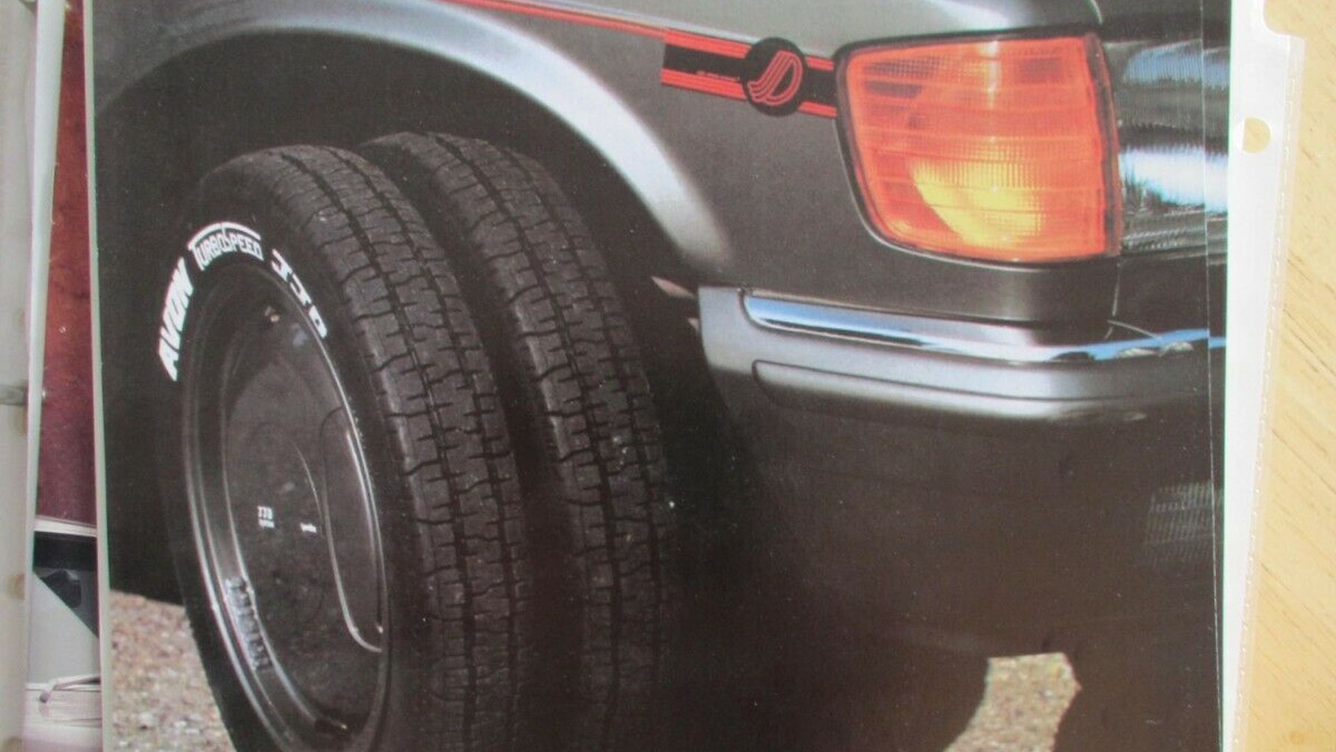

That's cool. Bolt on floatation!
Reminds me of these.
Reminds me of the Michelin TRX plus 1 metric tires. I think they only came of Fords early 1980s. I had an Escort with them. It was a blast to drive, hotter than Lee Iacoccas GLH but stupid expensive. Come new tire time I bought 4 rims ans 4 13" tires.... for less than the cost of 1 Michelin TRX Metric thing.
340 and 390 rather than 14 and 15
13.385" and 15.35" they still make them for the exotics... like Ferrari in a 415 size 16.338"....
