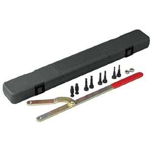

Universal pulley holder, purchased from Amazon.com for around $55. This helped with unbolting the camshaft sprocket and can also be used to help unbolt the crankshaft bolt for the timing belt.

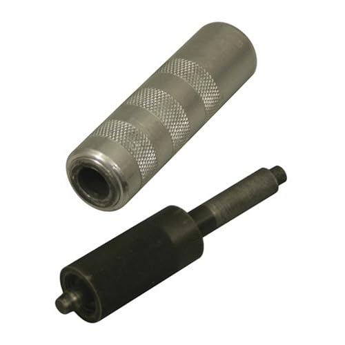

Lisle 36200 Valve keeper remover/installer - This was very easy to use and the magnetic base made it easy to keep track of the keepers. Not a lot of force is needed to remove or install the keepers.

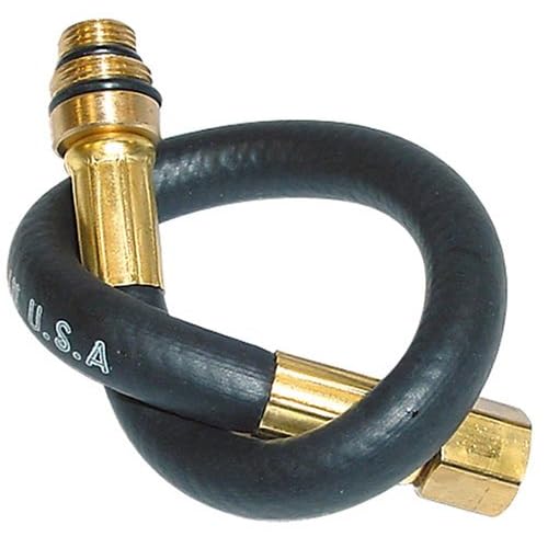

Lisle 19700 Valve Holder - if using this, you'll need a large capacity compressor as the pressure drops fast enough to cycle every few minutes. Using a pancake (2.5-5 gallon) compressor would not be ideal. Unless, it can keep a 100% duty cycle at around 80 psi.
