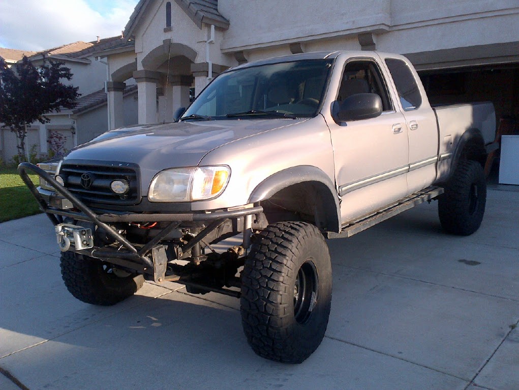

Installed the motor today. Hope to have everything else connected this week. Then I'll be able to start it for the first time in over 3 months...
dyogim
Put everything back together, flushed out the coolant, plumbed the hydro assist steering and finally started the truck for the first time in about 3 months. Excited to get the truck back on the road and driving again....

So far so good. There's a leak with the coolant bypass joint but, nothing too bad. I have the gaskets on order. As soon as I get them, I'll be installing them. Still need to wire the rock lights, wire up the LED strips for the engine bay, build the truck bed platform and put together the exhaust system to install my S & S (not to be confused with SS autochrome) long tube headers.
